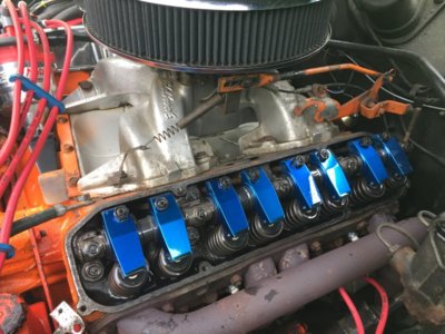

You have a 4150 - a double pumper and an automatic? How do your spark plugs look - are that black or sooty? I would go with a vacuum secondary carb for a street car unless you go tot he track a lot. Maybe try jetting down a size or two if the plugs show rich.
See the last time i pulled the plugs, i did up the heat range. (was 6, went to 5)
I don't do any track, just a street car.
Currently i have a 5.5 power valve (used to have a 6.5) on the primary with .78 jets and a blank power valve with .84 jets on the (mechanical) secondary.
The engine does not pull much vacuum, maybe around 7-8 Hg at most at idle but it is a steady reading.
I do have the feeling a PO did go to the race track with it but i have nothing to back that up, apart from the setup of the car.

your plugs are running rich with all that soot

I must say, this is what i found initially.
After i have rebuild the carb, changed the power valve and adjusted the timing.
It runs very well and as i was so proud of myself to get it going the way it is i forgot all about after care and double checking on my work.
Bear in mind, i never got there without this forum!
I should pull the plugs again and check, also still want to do a compression test at the same time.
Now driving about and looking the fuel meter dropping like a 200 ft tree that was cut i started to wonder if i was accurate enough or if there are still things to improve.
I runs great atm, starting it is a bit of a trick and once running you need to keep the rpm up for a minute to warm up a bit, after idles fine.
