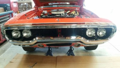

Mine for the front. A NOS piece at that
I'm an expert at nothing. But, those guards on any 71 is rarely, if ever, seen.
Same here, WileE. I didn't know it was or an option until mine had it originally
