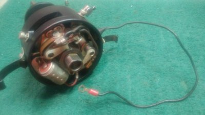

You need to validate the cam stop on this distributor. Since this is not original to the car, you may have a mix of parts installed. The cam stop has a 2 letter designation underneath. This is the last 2 of the part number and I can validate what distributor it comes from via the Autolite/Prestolite parts manual. Second you need to inspect and measure the slots for wear and help in determining how much mech adv that cam stop adds. Then measure pt to pt on the cam, I can tell you if that is stock measurement, worn, or a cam stop from a single pt distributor (they are similar for early ones). On the vacuum adv arm, there is a number, like 8, 9.5, 12 that is the max vacuum advance applied. Spring and shims provide the curve. How did you test? You can remove nipple and spring/shims and blow on it, does it hold pressure? If not diaphragm is gone and you will just have a vacuum leak with hose attached.
If you have a volt meter you can attach to distributor lead and body and watch and measure resistance as you slowly rotate distributor shaft. You want near zero resistance when either point closed. One may not be giving you that.
A true early Prestolite can handle the 8 to 12 initial timing because mechanical was only about 20 total. Later cars were CAP or CAS cars and initial timing was 0 because distrib provided 30-32 degrees mechanical advance (at crank).
Hard to see in second picture, but if you look at about 3 o'clock you can see LU stamp. That is the later 440/hemi cam stop with 15 degree mechanical which gives 30 total. Cars that need initial set at 0 degrees.
