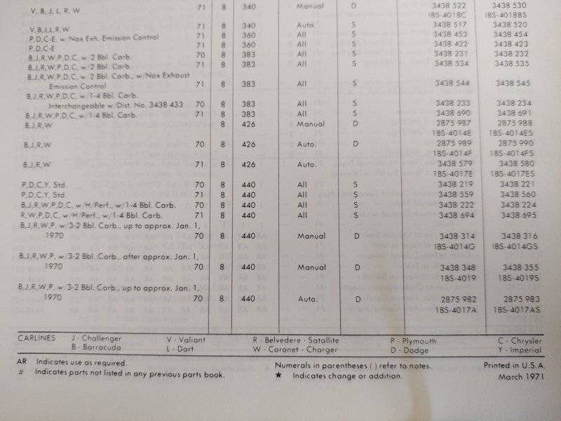

Like the title says I need the OEM part numbers for the points and condenser for a 1970 dual point distributor. TIA
Is the engine an LA or B/RB? the points are opposite hand for the LA engine. The condenser is the same.....Blue Streak stuff is great or ask Ray @HALLIFAXHOPS......
BOB RENTON
Part numbers sheets from my 1970-1971 Passenger Car Parts Catalog published March 1971
