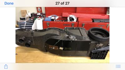

hello all.
Last year, just before the Nats, my heater core began to leak.
I pulled the box and plugged the heater hoses for the summer.
I dropped the heater core off with glen ray at the Nats and he shipped it back a month later.
Bob is a genuinely great guy and delivered as promised.
I bought a kit from dmt and cleaned and resealed the box.
My box was in great shape, having never been molested.
The front cover was I great shape and still has the yellow paint stamping on the front.
I soaked the bare metal pieces in evapo-rust and used RPM by ECS to protect them.
Overall, I’m pleased with the results.

Very nice work!

Nice to see a box done right!.....I would suggest to coat over the RPM with Boeshield or WD40......
Looks like your box was in very nice shape....Love the original fiber look....

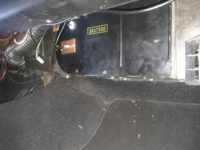

The stamping is in stellar shape can you make out anything on the sticker to the left of it? Looks like an inspectors sticker....
Unfortunately, the sticker was completely dried out and brittle.
I left the remnants as I thought it was a cool piece of originality.
I will say, these boxes are brittle and fragile. It wouldn’t take much to break one.

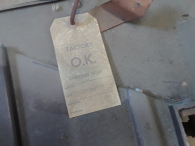

Thanks for posting an image of the inspector tag.........Here is the one that was on mine....
They were placed on every box on the line and were supposed to be removed when installed....but some made it through...

Glad you left it there because it was a factory tag of some sort......They are very brittle. I always keep an eye out for a spare....The parts guys know it and when they have a nice one it has a nice price to follow....It is very hard to find one not cracked/broken...

Mine is in a ziploc bag now with other historic documents from the car. Very brittle. Did yours have a date? Mine was ballpoint blue ink scribbled on the back of the tag and faded to almost not legible.
Mine is on the box in the car and they way the car is stored it will never deteriorate as long as I'm alive, lol.....There were no markings on the tag.....

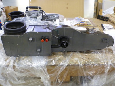

Your cowl seal looks 2X the height of mine (and my DMT seal was shorter than what I took off?). I wonder if DMT uses different suppliers, or if I got the wrong one? I bought mine through Mancini on their Black Friday sale (with other stuff I needed).
My original cowl seal was not glued on, hence I didn't glue the replacement. Well that lasted about two minutes as I wrestled that box back under the dash. I PLIOBOND that seal on and 15minutes later it was cured and continued the job. The seal is good enough in height that it is a tight seal, but in pictures your looks taller?
Not sure about the cowl seal.
I will say that the DMT fit well circumference wise and it looks similar in size to the crushed original I removed.
I would imagine it will crush and take a set over time

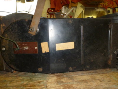

DANG... everyone told me my stickers weren't factory when I asked a couple years back! I had two stickers and no evidence of a part # stamp. Oh well, couldn't read anything on them.

I know that was not me that made note of your stickers.......Notice the one sticker is similar to Robs.....
Yep, looks exactly like his sticker.. and I bet the long one was the part number on paper as they'd lost their ink stamper! LOL
