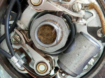

Please see the image below pointing out the screws that I have holding my points down

When the point arm opens is it touching the screw head and grounding? If so it will act like the points are actually closed. Think that is what HF is saying.

Just tried turning the distributor with the vacuum on and off of the advance, and I did not see any contact between the points arm and the screw.

First thing I see here is the top set of points in first picture are on the flat of the cam and look to be open when they should be closed !
They are hitting the screws at RPM almost guarantee I they are philister head, you need two pan head screws. That clip is fine. Mostly what I use you cannot get the square ones any more and e clips have a habit of falling off also. I also see the points on top need to be aligned better.

Not trying to start a debate,but there is nothing wrong with philister head screws if they have the correct head size,this is an untouched,never apart 66 Hemi Prestolite with original screws.The screws in his picture are not the original.I just finished these yesterday and the points will actually clear the screw head with the ground wire and washer under each.

Those are the right pan/button head screws for sure. The fillister are like the ones on the vac advance. Kind of like a small tub? I will see what I can find pic wise.

Good chance, on that Prestolite, if the screw heads are too tall, points are getting grounded out.
It is a bad picture, they are in fact closed now.
Do mine look that different? I can't tell.

If that is correct, perhaps the issue is the screws that holds the points down.
While there is no contact when I turn it by hand, perhaps under speed there is flexing or some up and down movement that creates contact?
