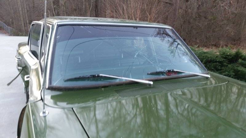

Sorry if this is the wrong section, or if I missed a similar thread, I hope I did it right.
Anyway, a back in January my Coronet got wrecked by an inattentive driver (no drivetrain damage, I was able to drive it home), and now I'm wondering, what would be the expected price for fixing this sort of damage? I'm not talking about the doors, quarter panel, or windshield, but the unibody damage and the B-pillar. Is this something in the ballpark of 1k, 5k, 7k, or even more than that...?
20190111_075003.jpg 20190111_083832.jpg 20190111_084448.jpg 20190312_175348.jpg 20190312_175353.jpg 20190312_175407.jpg
Is the floor buckled?
To disassemble I would go 8 hrs, pull doors, fender, windshield.
From there who knows. Did you find a frame shop that’s willing to work on it?
Put it on a frame machine and start pulling. Rocker may need cutout and replaced along with B Pillar. Probably 20 hours? That’s with no rocker or floor replacement. If you had sheetmetal in hand for rocker and B Pilar that’s another 20-40 hours. From there your ready to fix the rest, quarter, hang doors, fender, etc.
At $70/hr your looking at $5-6k? Just thinking out load.
you could probably find another car for the money you would invest into saving that.
especially if you do not do all the work yourself..
good luck

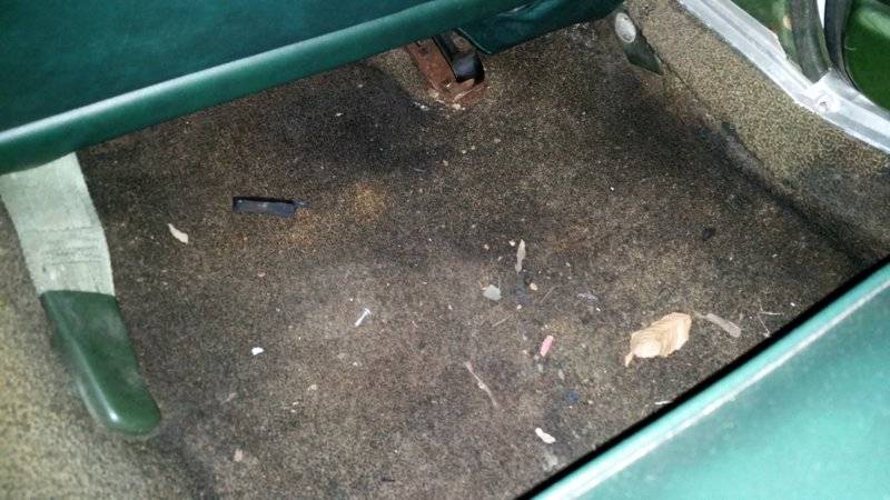

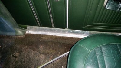

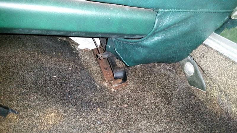

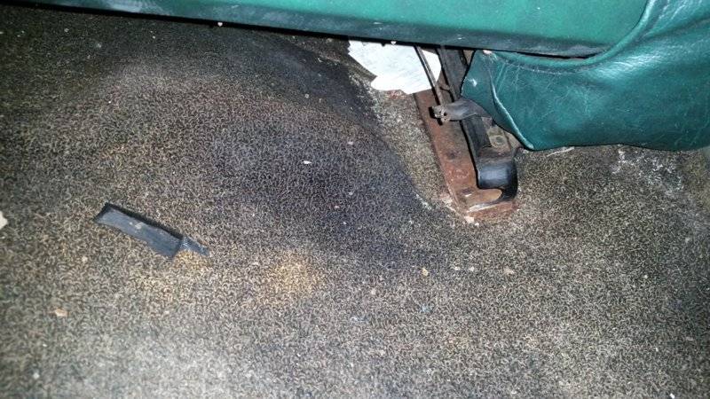

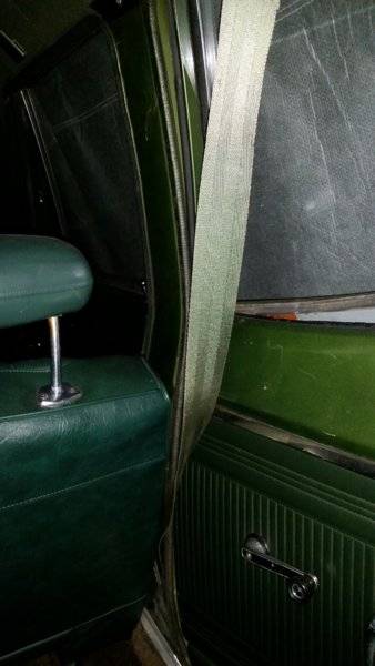

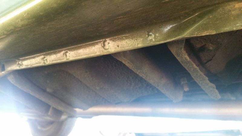

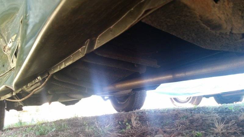

I have not yet contacted anyone, been having other stuff to work on. Just went and got some photos of floor; not the best though as it's night.
good luck

that isn't going to be a cheap fix, inner rocker moved in
and that will take a lot of digging and time to fix right.
is the roof buckled?
at over 5k it might be time to look for a parted one
and move your parts over.
I could see 7 to 8k easy more then that wouldn't surprise me
it has to hit a frame machine and the floor will probably have to come out
not trying to discourage you
but be aware of what you are up against.

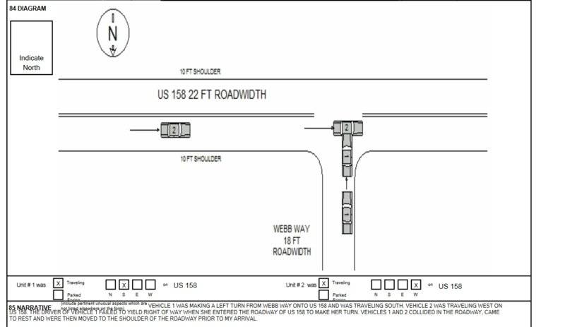

And yes, other driver was total fault, ended up getting back nearly 3x what I bought the car for.
