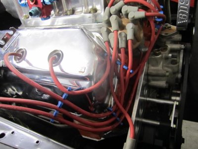

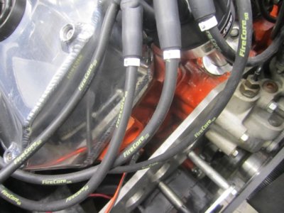

Here’s my setup it might work for you I use a ford 3gen alternator 135 amp
I welded a tube to the water pump housing. Then cut the 1/2 moon adjuster slot in the motor plate itself.

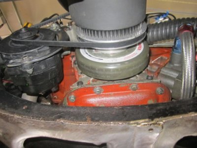

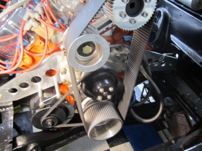

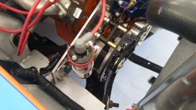

My alternator was moved down low to make room for the catch can off of the vacuum pump.

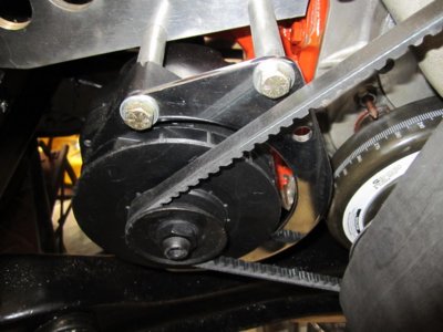

I run the east coast ultra mini alternator with the DMI low mount bracket and pulley. Nice clean setup.

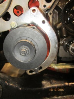

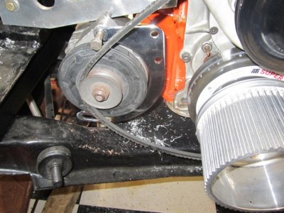

Hi NSS Guy. I have the set up you're talking about. I grabbed you some pictures from the bottom side. Check it out. Oh and this is a Denso Alternator off of E bay. Lightweight, about 65 bucks, good amps. Pulley included.
Solid mounts so the adjuster is on the frame. Works well. The heim joint and rod goes to the motor mount ear to hold the motor. Got one on each side.

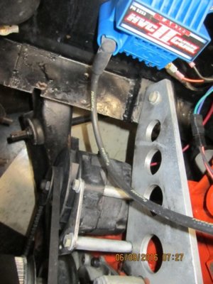

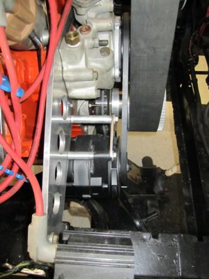

The AR engine plate has alternator bracket holes already. My bracket is just a piece of 1X2 tube, angle cut, 3/8" bolts from the inside of the tube facing backwards and tac'd into place. Just tighten the nuts behind. The bottom bolt, same thing but facing forward.
Just a better shot of the 1 X 2 tube bracket. Alternator lines up perfect for the belt alignment.
Ok hope this helps you with your own plan. And the alternator keeps the battery up just fine. Sometimes I will give the battery a shot with the charger when I'm standing around, but not req'd if short on time.

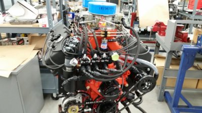

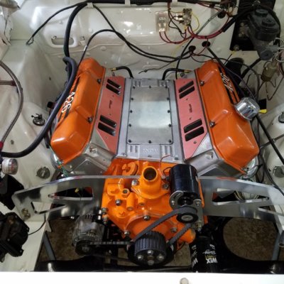

here'
s mine,,,vignogna racing motor plate with a 1 wire 135 amp toyota alternator..
