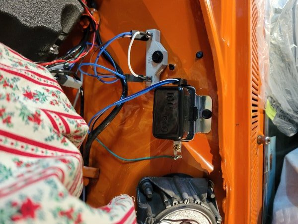

I searched through a dozen threads relating to alternator/regulator setups and found a million answers but none of them seemed to be confidently relatable to my situation, so here goes.
1966 Charger, originally a bone stock 383 car, now has 440
ACDelco 3342086 Alternator
SMP VR101 Regulator
All new wiring harnesses front to back from Classic Industries
I was figuring just connect the new regulator to the normal connections in the harness, and boom we are good. At first I did not notice that the alternator has TWO spade connectors (sadly unlabeled) rather than just one. I smoked the regulator after hooking these up and putting the key to ACC to test some other circuits for a minute. I then noticed the two spades on the alternator at that point, so I disconnected both connections to the alternator. I put the key to ACC later on (alt still disconnected) and the regulator smoked again! Struggling to understand how that is possible... Anyone got any insight? I am happy to provide any additional info if I missed anything.

Thank you for this answer. This gives me something I can check! I do have a replacement regulator on the way. The harness I have has a green wire with a sideways connector designed to attach to the screw thread on the regulator at one end, and a matching green wire with a female spade connector right next to the ring terminal that goes on the alternator. I feel pretty confident is the correct wire, however, your point of it maybe simply being on the wrong terminal, the first time and cooking the regulator might be the simple answer. Once I identify the correct terminal for that green wire to go on, do you happen to know if I am supposed to ground the other wire, or simply leave it disconnected?

You are correct that the wiring is very distinct within the harness. I referenced my factory service manual when making the connections. The ballast resistor connection that is nearby utilizes different colored wires. The regulator uses a blue and blue with tracer wire for the other side and there is only one connection which that available.

It is not a square back from what I can tell. Those have a distinct "grid pattern" on the square portion of the alternator. It is a remanufactured round back, but for some reason DOES have two terminals. twecomm gave me a way to test which terminal is the correct one, sounds like as long as I use that one it should function like the old style.

Quick update, I spent some time yesterday checking these things out and got to the point of being comfortable enough for a test. Lo and behold, @Iroc78 appears to have been correct about the regulator simply being prone to smoking a bit when you first use it. Never thought I would have to "caramelize" my regulator before use... haha. Tonight we will be doing the next run test, and I will be ensuring the charging is working properly etc. Thank you again to everyone for their input!

FBO Ignition has one, almost looks like the orginal. Not sure who makes this square one. The one on my firewall is the FBO. Not sure why my pictures often get turned around!
Ok so I am STILL at it. I put in the new regulator and the car immediately started charging nice and strong. Even better with some RPM. I wrapped up and drove the car home, but just a few minutes into the drive the ammeter dropped back to drain again. I discovered one of the brushes had failed (got wedged and broke apart) so I figured easy fix, and dropped a new brush in, being sure to align and seat it correctly. Unexpectedly, still no charge...
I did a bunch more testing but the end-all-be-all was a super quick full-field test (thanks to @dadsbee for the recommendation in another thread) which yielded 18V immediately. That tells me the alternator is actually fine, and we are back looking at the regulator or a connection issue again. Does anyone know what kind of voltage (or other signal?) I should be checking for on that green field wire? I plan on checking it at the regulator itself and at the connector on the alt, which should also assist in diagnosing if maybe the green wire is damaged in the harness somewhere.
