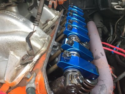

Hey guys,
In my '69 Coronet R/T i have a 440, which has been rebuild in the past but i have no specs about it.
The engine has a bit rough idle and low vacuum (10Hg) so i want to find out what camshaft specs it has in there.
By knowing the specs i might not find the exact part number (who knows it is a one-off grind) but i can hopefully determine the effective rpm range of this camshaft by comparing it with other camshafts with similar specs.
Current converter specs are also unknown, (someone advised met to do a check on the flash stall to get a close idea of the stall speed)
As i want to change my 4.10 ratio rear axle to a 3.23 or 3.55 ratio so i will have to consider all this to get a decent match for drivability. (cam, converter, rear axle ratio)
So, to do this i ordered a degree wheel and got a magnetic stand with digital dial gauge.

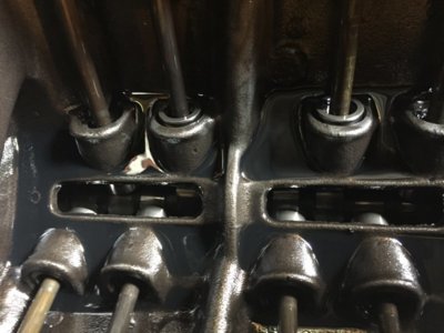

I know i have flat tappets, most likely hydraulic ones as i can see a circlip inside on de pushrod end. (maybe not, but hoping you guys know why the circlip is there, see pic)
There is no valve lash at all at any time, the push rods can be turned by fingers when the tappet is on the base line of the cam. (not loose, you need to apply a little force to rotate them)
I want to clear these things up first:
* Can i use the dial gauge and take the measurements on top of the rocker arm, right next to the adjustment screw of the push rod and confirm degree's and lift?
(setting it up in such a way that it is inline with the angle of the pushrod and in center of the adjustment screw)
* If they are hydraulic tappets, will they not cause a false reading when checking due to oil loss or so when they fight against the valve spring?
I am not sure about the rocker arm ratio (think 1.6) so to avoid a false reading due to incorrect ratio correction i want to avoid measuring on the valve spring retainer.
I don't want to pull any parts out because with my luck i am bound to **** something up, and there is no need for pulling parts out of this working engine.

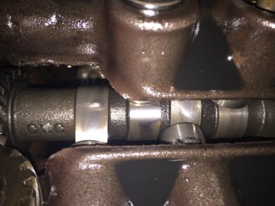

Regarding the camshaft, the only ID i found on the camshaft is CWC.
I traced it back and found this is Campbell, Wyant & Cannon, located in Muskegon, Michigan and they don't exist anymore under that name, now called Kautex, a Textron company.
And they manufacturer camshaft casts.
The do not do any grinding, just make the raw casts and sell them to the manufacturers who grind them to their own specs and sell them to the public.
It might be this is a one off grind done by a machinist who made a specific camshaft for a client, it could be as well that a company like Comp Cams or any other camshaft manufacturer use these as well, no idea.
Any thoughts and suggestions are welcome as always!!
Thx for reading!!

you just about can't check much of anything at the valve or rocker with a hydraulic tappet; especially with a non-checking valve spring. you still have to find TDC and using a positive stop in the spark plug hole isn't perfect. you can find some information but accuracy will diminish quickly with the hydraulic tappet. if you use a solid tappet and a checking valve spring, and TDC is accurately located, then you should be good.
Thx lewtot,
I was in the understanding that TDC can be accurately found using a positive stop when letting the piston hit in both rotation directions, note the degree's and after hit for the middle of those figures.
So with hydraulic tappets i should remove the rocker shaft and remove the push rods on cylinder #1 to get the dial gauge installed directly in the center of the tappet.
But i am not sure if these are hydraulic tappets, i assume these are hydraulic as they have a circlip inside, and i believe the solid tappets don't have them. Also hydraulic tappets have preload and no valve lash right?
Thx lewtot,
Yes, you can use piston stop as you've described to find TDC.
You might be able to indicate from the lifter if you remove a pushrod.
Normally we measure lobe lift by subtracting the width dimension from the height dimension.
Then multiply that number by 1.5 (or your particular rocker ratio) to define advertised valve lift.
If you can't pull the cam, you might get close enough by doing the indicate from lifter noting the smallest number while rotating engine and zeroing dial indicator. Then probably subtract the valve lash from the highest number indicated. Of course you still multiply that by your rocket ratio.
Check both an intake and exhaust lobe..
Using the degree wheel you can get close to the correct installation by understanding measured degrees between the intake and exhaust lobe split. In otherwords, find the highest lift on intake and note degrees. Find highest lift on exhaust and note degrees. The point in degrees opposite between is the split at zero lift... This should be TDC of crankshaft. If not, adjust accordingly.
a positive stop is not as accurate as an indicator on the piston. this might be splitting hairs for what you want to do. if you can find a stem extension long enough to reach the tappet, solid or hydraulic, that would take the rocker out of the equation. you will need to remove all plugs and if it were me i'd take the other 7 cylinders out of the process by not rotating the engine with the whole valve train hooked up.

As mentioned before the manufacturer of the cam is CWC, which could mean it is a custom camshaft so there is a chance that it will not have any part numbers at all.
Bear in mind that 10-15 years ago this engine was rebuild the ease of getting parts from the US was not as easy as it is nowdays.
Therefore some machinist might have got the right camshaft cast and machined it according some specs
hydraulic tappets do have an internal spring, plunger, and check valve. the whole system relies on constant pressurized oil supply. take the supply away and the internals eventually collapse due to valve spring pressure.
CWC is probably the manufacturer of the cam core, not the grinder. most likely it's a shelf grind and not custom.
