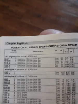

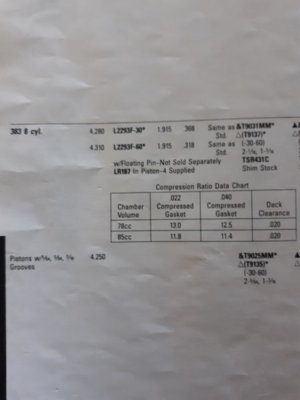

This isn't really any new info for you but the image is right out of my 1989 TRW book and a 1996 Federal module book ... most 906 head we have measured have been 90cc making it about 11:1 but I would guess 10.75 :1 or less since factory machining vary A LOT. You would have to measure the piston deck height. The 12.4 rating is for a closed chamber head. On any used engine spin it over for tight spots...take a valve cover off look for rust. The seller should be concerned what he is selling..or you need to buy from some one who cares. And as far as rodents..2 years ago I had a critter chew a hole through a intake hose on a 8.3 Cummins diesel and filled the engine up with soybeans 2 the point the engine locked up. I didn't have 2 overall it but had to do the valves and take it completely apart. Mouse pee is super corrosive. Lol. The mice moved 5 gallons of soybeans into the engine in 1 month. I was shocked when it wouldn't start
