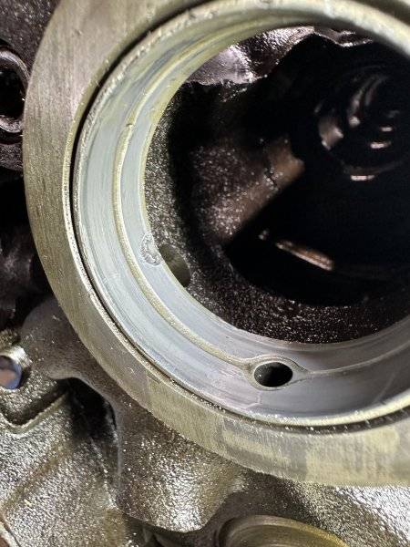

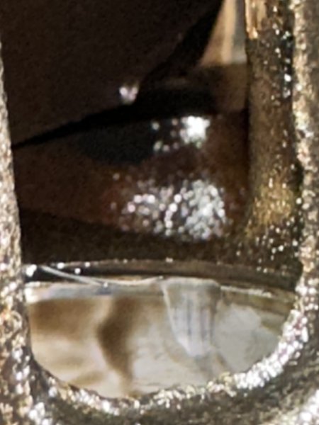

Tonight I got the cam out (after doing a bunch of research because I've heard they can be a bear on these big blocks). Sure enough, it fought at first but once I got it to move it came right out. Cam looks perfect, aside from the dowel pin being broken (which I am scratching my head about, no, its not in the cam gear). No abnormal wear that I can see on the bearing surfaces or lobes. However, bearings 1 and 2 are trashed. (I'll upload some pictures to show you). Bearing 1 has a big chunk missing right at the bottom. You can see the block surface. Bearing 2 is missing a chunk too but it's not as deep. There are some small marks on the bearings from me removing the cam but you can't feel them with your finger. I'm not sure if the marks are my doing or not. I looked around for little bits of bearing but I couldn't see any.
I'm wondering what I can do about these cam bearings. What would you do? I was already planning on replacing my cam. Can I just replace the two damaged bearings or do I need to replace the set? Thanks in advance!

Looks like they guy installing the factory cam got a little sloppy. I would replace the set of them. Might be a chore to bring it to a shop with cam bearing install tool. But they are not out of reach price wise either if you choose to diy them.

I'm looking at cam bearings and tools now. Both look pretty affordable. I'm not sure what I'm gonna do yet, I have never replaced them before!
Factory cam bearings flaking and chunking is not uncommon. They seem pretty fragile. But if it's all apart maybe get the block hot tanked and new bearings installed at the machine shop

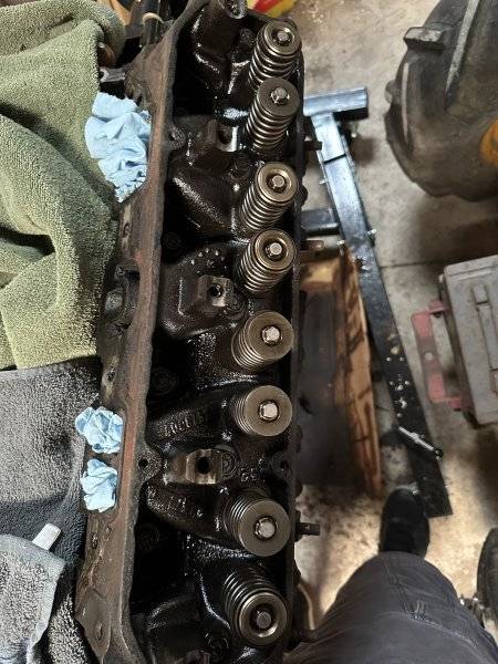

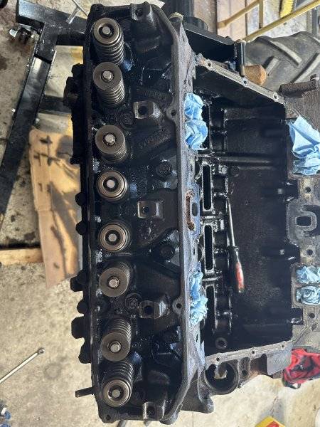

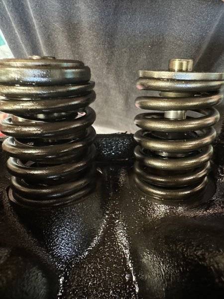

In the mean time, my cam and lifters have arrived. I decided to go with the Edelbrock perfomer cam kit 2192 (which is a comp cam and lifter kit in an Eddy box). Edelbrock states in their instructions that no warranty is granted on this stuff if I don't install their valve springs which is OK with me since I was already thinking about replacing them. While I was out there this afternoon I noticed something interesting though. I'll post some pictures to go with my description for you all too.
Some of the valve springs on these heads appear to be dual spring. Look at the photos, the valves with a flat retainer have one coil underneath. The valves with a rounded retainer have a single coil and then what appears to be a secondary coil inside that. On the right bank only the exhaust valves have the rounded retainers. On the left bank they are mixed. I'm curious as to why they are like this? Between this and the buggered cam bearings I'm beginning to wonder if this engine hasn't been apart before. There's no sign of them causing any problems, I just find it strange that there is no rhyme or reason as to why they are installed like this.
Has anyone here seen this before? Please let me know. I hadn't even thought of it before but I think I'll need to replace the retainers when I do my valve springs.

Yup someone mixed up 2 valves. But in the end they're crappy springs, retainers and keepers.
Good to know. I was scratching my head there for a minute trying to figure out the sense behind it. Oh well, I guess a few more new parts never hurt anyone! lol
Motor home would have valve spring rotaters on the exhaust valves Those are the thick looking retainers. You’ll need the proper springs and correct retainers that fit the new springs.
Doug
Fwiw, I prefer to eliminate the rotators.
On any heads I’ve seen with them, when the factory used rotators, the ex valves had two grooves.
If you simply swap to std retainers, the spring installed height can change……. So it needs to be checked.
(On a SB, the installed height ends up short enough to where the valves get swapped for 4 groove versions to get the installed heights close between in & ex)
