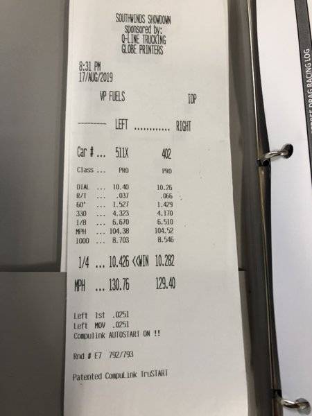

Congrats 7 rds is always good. Without looking at the slip I'm calling .015 mov. Lets see.
Doug
Here you go. My wife told me after the race that she was going to tell me to leave 10.42 on the window. I switched to 10.40 right before the race.

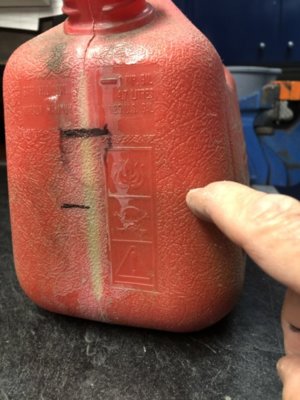

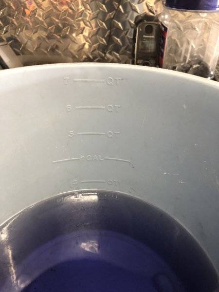

Yesterday was a day full of troubleshooting and tests and I’ve found that my fuel volume is way low, which explains the layover. Needless to say, Jegs got rattled good and I’ve got some upgrades to do.
When I originally built the Plymouth the goal was to crack a high 10 with a fuel system to accommodate. It’s sure not accommodating 10.0’s.
Rule of thumb for a 10.0 car is one gallon in 20 seconds or less for a one carburetor set up.
A half dozen tests made at 20 seconds. Not quite 3 quarts. Ahh-hah. Check it out.

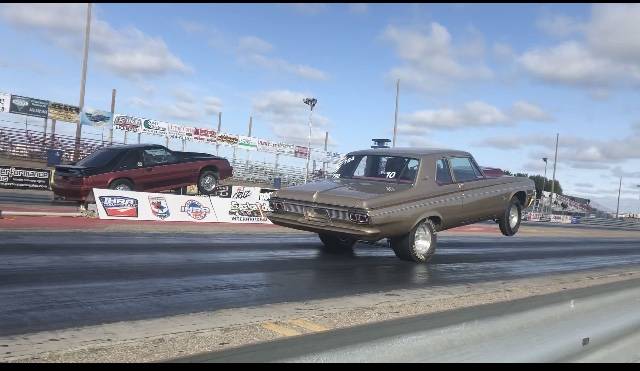

Pic from day 2. 1.340 60’. (Same run that my car went away by 6K in second). Finished with a 10.13 to my 10.24. Sucked to have the tach stop climbing and the FFFord go by! No choice but to grab 3rd and run it out.
The Mustang is another local racer to me. I read a post that yesterday that called us the Regina Air Force. Lol.
