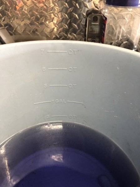

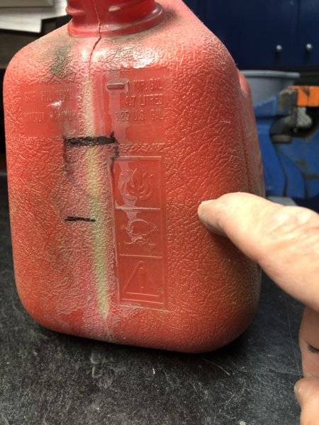

Yesterday was a day full of troubleshooting and tests and I’ve found that my fuel volume is way low, which explains the layover. Needless to say, Jegs got rattled good and I’ve got some upgrades to do.
When I originally built the Plymouth the goal was to crack a high 10 with a fuel system to accommodate. It’s sure not accommodating 10.0’s.
Rule of thumb for a 10.0 car is one gallon in 20 seconds or less for a one carburetor set up.
A half dozen tests made at 20 seconds. Not quite 3 quarts. Ahh-hah. Check it out.

Upgrades coming are -10AN line, filters etc from cell to regulator and A2000 Aeromotive pump. Replacing the -8 system and 150GPH pump. Hopefully next outing will be better for Malex! View attachment 820576
