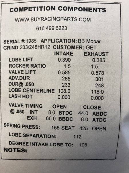

First question camshaft:
I have the following hydraulic roller cam with CompCam 1,5 roller rockers.
delivermessagepart
Would that be ok for a 451?

Camspecs now visible?
Here everything seems ok.
If not I will write them manually later.

I don't think competition components is the same as Comp Cams?
The cam specs look OK, the 233 duration @ 0.050" and 112 LSA should be very driveable.
Not sure why it has such a large split between intake and exhaust duration?
Depending on your fuel, may want to keep compression at 10:1 with that cam. With 10.5:1 compression, may want a cam with around 240 duration @ 0.050, and at 11.0:1, around 250s duration @ 0.050"

Looks like a Scott Brown cam to me.
I cannot see the cam spec but I would advise to " run what you brung" run your existing cam and see how you like it so you better know which way to change
did you post trans and gears, weight and how you want to drive
no way to make a cam suggestion
you could also send all your details to Mike Jones Jones cams go to his website and fill out his cam select card
his inverse radius flank roller cams cannot be beat
I can't tell what the seat durations and timing are from the cam card
can you get the duration at .006 and the timing at.006
.050 is more for degreeing the cam as how fast the ramps are - what Harvey crane called "intensity" makes a big difference and can have cams that are quite different with the same .050
throw in the .200 durations and lets see how that thing breathes
lots of discussions on HR here personally I would not spend the money but put it toward some EDM FT lifters and adjustable rockers
if you go roller tip rockers check out the B3 website tech articles- would Iron rockers work fine with that cam ? IDK scott brown
also I'd run the lighter beehive springs and retainers
you need to have any otb head checked
The cam on the cam card you have already- use it
B3racingengines.com (I think) and read all 3 tech articles
if running roller rockers here is a place to spend your hard earned dollars
