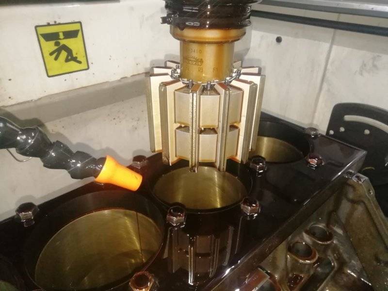

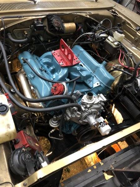

While waiting old engine comes out
A22810E2-9727-47F4-B689-E5553F54CD71.jpeg 82DA8CA7-7778-427B-9F3C-E2CF19C2C12E.jpeg
are you going to mock it up at all 4 corners to check deck height, etc?
what bore?

It‘s 4,360

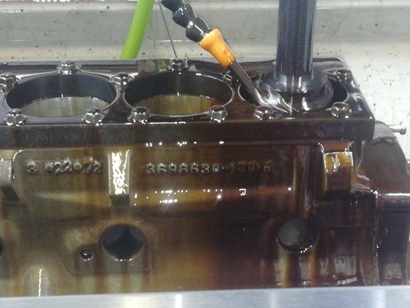

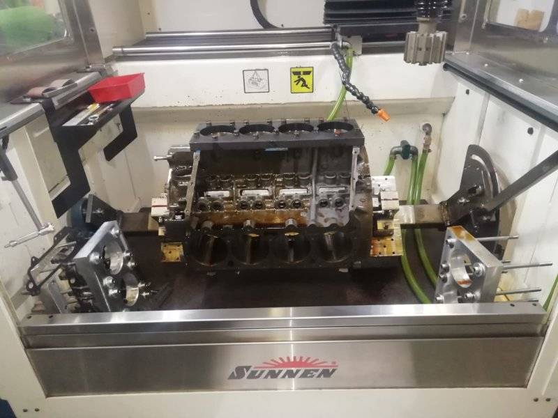

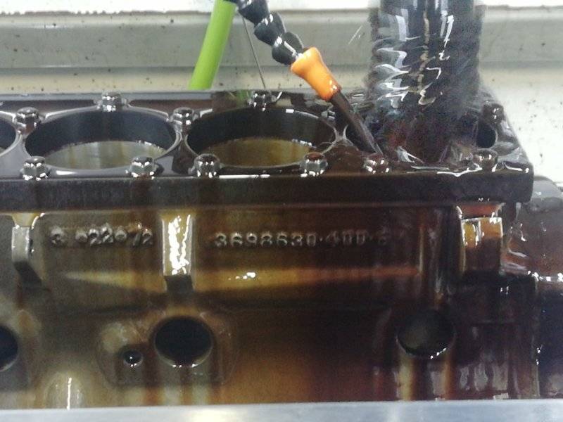

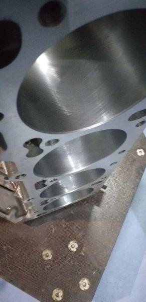

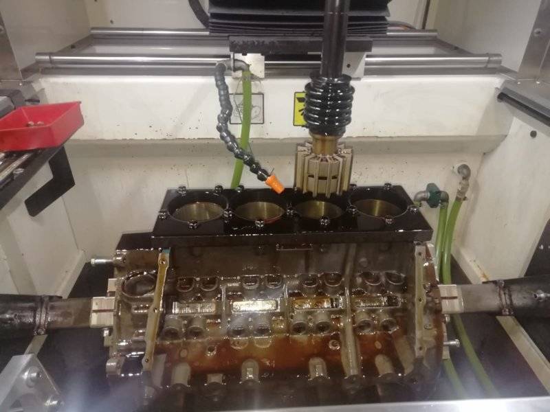

Decks are checked and corrected.
Get‘s the mains checked and a few oiling mods too.
86BA26FE-D16E-4CB7-80BA-2D71F7A25721.jpeg 2E0281DF-EB8C-4071-86C4-C92B2165195A.jpeg
so estimate your quench with .028, .041, .052 gaskets
and target head ccs and resulting compression
I usually do not deck the block without a mock up of the deck clerance of the pistons
what oil mods
this is a stick?
I like to modify the thrust by drilling a .042 hole through the thrust bearing and web into the oil feed and then open up the bearing larger to pressure lube the thrust
also chamfer from the oil grove along both parting lines back toward the rear of the crank
for really high rpm or marine i mod the main oil feed to side oiler grove the block to the parting line and open the side of the bearings at the parting line to get oil in closer to where the dynamic wedge needs to be formed

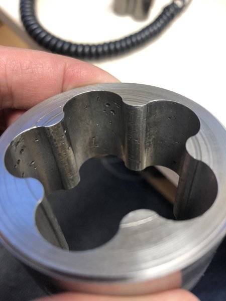

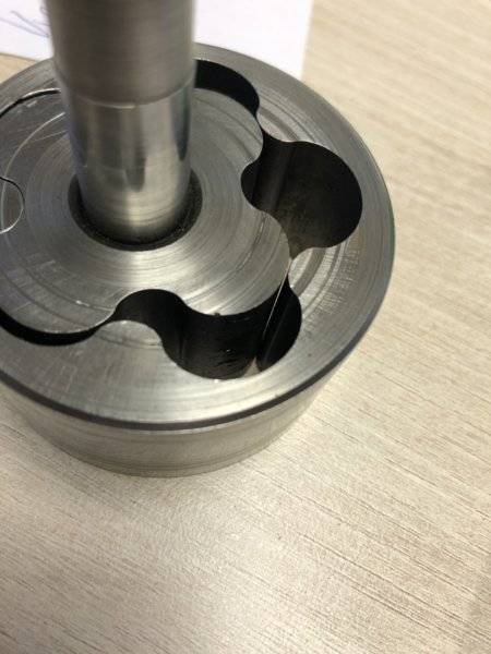

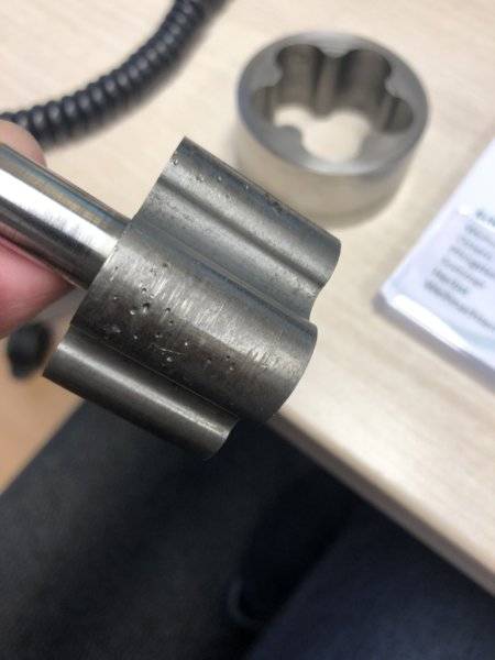

Btw the reason for my Engine failure.
Can‘t say what this did

What actually failed on the first engine? The pump obiviously had debris go thru it. I've seen that kind of pump damage from nothing more that a fractured valve spring.
Doug
Are you doing this motor's oil system this way because of the previous motor's failure? Did you determine the true root cause of the previous failure?

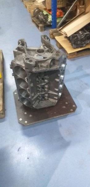

I had bad luck, because my first 400 block has a crack.
Next blocks are waiting for Oliver´s container in Houston.

Had two problems:
Minimal but consistent loss of coolant.
This was a fault in the block between cylinder 1 and the front coolant passage.
Second was the loss of oil pressure.
I didn´t found anything which could have caused this.
No spring, no roller, nothing

Will check your block, we unload this containers at my warehouse;)
