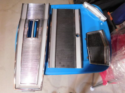

Thanks for posting pictures, I'm not brave enough to pull it yet, plus been having too much fun just driving it! I'd love to keep in touch with your progress through this forum or direct!Here I go ... man I'm hoping this goes well. Pulling gauges before the car goes into storage, be ready for the spring. Don't know about getting that pad out.
View attachment 847687 View attachment 847692
