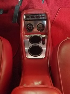

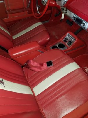

Agree with 66383 Herb's. I toyed with a few interior paints that were crappy most to do with off color. Someone on our forum suggested Herb's found Herb's to be the way to go. I had painted my visors with another brand that was off color then used Herb's on the modified leather console I installed and match came out nice. Attached before & after off the console using Herb's as FYI...only thing is the seats have seen years of daylight; but real happy with the match.
View attachment 889509 View attachment 889510
What is the console originally out of? It looks very nice. Got any close up pics of it?

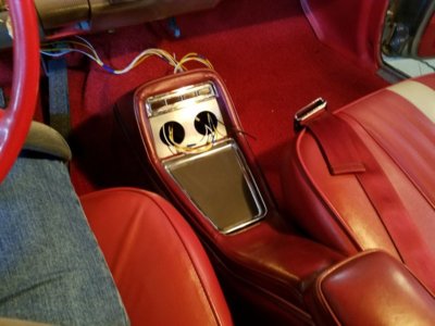

It's from a '78 Lincoln leather having an idiot light bar I reconverted to display blinkers, brake and headlights. Used the stowage cove it had for extra gauges and added cup holders a buddy machined from a scrap alum block. Got the console at a swap meet some 15 years ago for 10 bucks. Still a few things left to finish. It's the correct red from Herb's; but the seats and dash have have many years in the sun as a drop top so they're faded not producing a perfect match. Attached a couple pics showing it during install as it was a maroon color initially. The card board piece you see was the template to make the side aprons from panel stock, foam, and vinyl covering.
