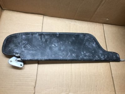

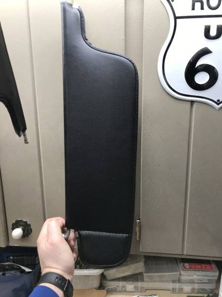

I used SEM
24745009-43CC-4F77-BEBA-F00297EAFC7E.jpeg 391D08AD-154E-4AB6-B84E-0219A456E5DF.jpeg

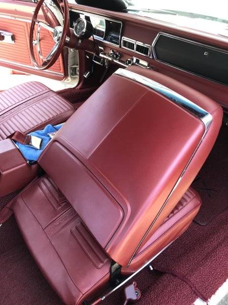

I recently used Kolor Korrect for some interior vinyl paint for my 67 because I needed a match for the mettalic red and they work closely with Legendary on color matching. It did match very well although the metallic is probably a little more evident than original. The seat back in the photo below was sprayed with it. But they are pretty expensive and a local PPG dealer is a more cost effective alternative.
