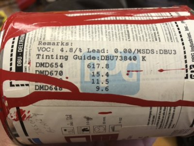

The car was sprayed with Deltron DBU. I have no idea how old this paint is, but I'm guessing 15+ years old. I'd guess there's about 1 cup of color left. I also see that DBU is no longer made, so what would you all recommend as an alternative?
So, I'm looking for a low-volume way to cover up the mess I've made. :)
I'm not completely opposed to taking it to a shop to get painted, but I figure I can fumble my way through this, learn a few things along the way and eventually get a satisfactory result.
Based on the above, what do you suggest is the best way to go about it? I'm happy to try it the traditional way with 2-part paints and a detail gun. I've also seen that aerosols have come a long way and you can get 2k paints and primers in spray cans.
Also, there seem to be 2 zillion glazing putty alternatives. People seem to really like Evercoat, so I was looking at EverGold or their Polyester Glazing Putty. EverGold says it can be used over cured 2k primer whereas the Polyester Glazing Putty only mentions cured OEM paint.
Any help would be appreciated! 5992EDFD-0939-46E2-A5BB-671B15503DCB_1_105_c.jpeg

I would take your color to a PPG jobber and match it to a single stage. Take as much apart as you can and then tin foil and mask the rest. Spray away.

You can call your local paint supplier and give them your paint code and they will mix up a base coat / clear coat or single stage paint for you in a rattle can . Around here it's about $20 maybe for them to do it, buy one and see what you think. I know of quite a few guys around here that have done it this way with really good results. The base then clear looks a little better than the single from what i've seen.
