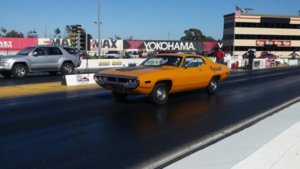

Grudge race my stock '72 Satellite 318 vs daughter's stock 2004 Toyota 4Runner 4.0L (I lose) Her first time at drag strip, my first time in forty plus years:
Mar 30, 2016 Sonoma Raceway Wednesday Night Drags
4:44 PM Ody Rubi 4:17 PM Ody Rubi
R/T .286 .723 1.126 1.136
60 ft 2.905 2.455 2.646 2.589
330 7.826 6.824 7.588 7.071
660 11.920 10.513 11.807 10.811
MPH 60.06 66.97 58.82 66.33
1000 15.440 13.644 15.377 13.984
1320 18.413 16.384 18.368 17.045
MPH 75.79 82.10 75.37 66.11
On first run, Ody experienced bog at start, had to lift accelerator then apply.
On second run, Ody feathered accelerator to prevent bog, ran 0.045 slower ET, although MPH increased by .42 MPH
On both runs it seems Satellite shifted into 3rd gear when already past finish line.
On first run, it appears Rubi slowed down before the finish line, won by 1.323, then won by 2.029 on second run.

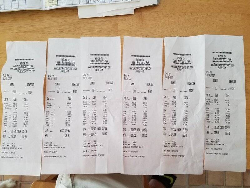

Average is a big question. The car itself cam react slow. My V6 Magnum is mid .150 rt (normal shallow stage) with me driving. In my race car my average is in the high .020s. First you need to be consistant. Whether that is .020, .100, .200. Then you can adjust your staging accordingly. A slow reacting car needs to go in deep. Just because a car has a slow ET doesnt mean it wont cut a light. Our old Dodge Caravan could go .020 easily shallow staged. My buddy's 69 Hemi Charger couldn't break .100 with me driving it. But deep staged ( top stage bulb out). It could go .010. You can win a lot of rounds with an .030 or better. Even .040-.060 will win a lot of times if the car is dead on. It all depends on how good your opponent is. Not many can go .01x or better everytime.

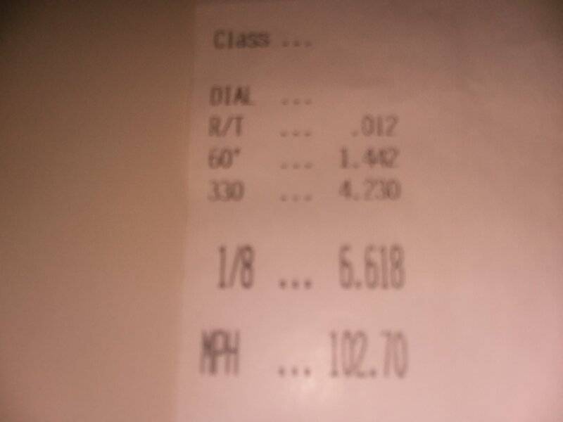

However, put me in a decent car, I can cut a light. This was the third lap I made in a friend's car, that I had never even sat in before.
I guess my point is....it depends on what you are driving. For your typical once-a-decade trip with a pure street car, any three digit reaction time that starts with a zero, say .098, I would consider a really good light. A really good racer would consider that .098 a disaster.

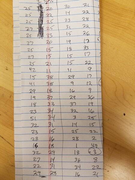

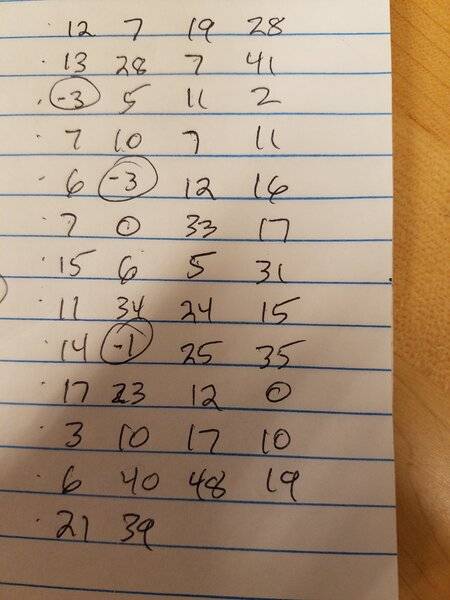

50 hits on the full tree this afternoon and 100 on pro. Same 350 rollout. The pro hits keep you honest
