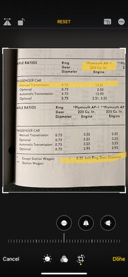

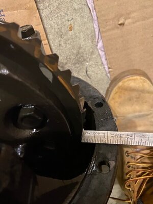

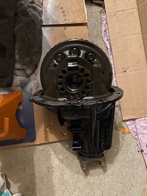

I'm posting this as a caution to novices (like me) and about the rat holes we can chase with these cars. I'm doing a restomod on a 65, 2 door post Belvedere. Originally a /6 with 3 speed manual and converting to 383 4 spd. I've been taking care of rust underneath and took the rear end off to get access to wheel wells. While the rear end is out, I plan to switch the open diff to a Sure Trac. So I purchased the seals, bearings and diff, etc from Dr Diff for my 741 8 3/4 rear end. THEN I decided to look at the fine print in the spec section of my Service Manual. It says my 225 cu in engine with manual trans and the 3.31 gears that it has in the rear end, contains an 8 1/4" ring gear. Arggg!
After talking with Cass at Dr Diff, the Sure Trac that I purchased will not mount to the 8 1/4 ring gear. So my options are to purchase a new ring & pinion, yoke and conversion U-Joint, or keep the peg leg, or buy a new/used 3rd member. None are really the options I wanted.
Like I said, I'm a novice when it comes to diffs - the first time I saw the inside of one is this week when I took mine apart, lol - and replacing the ring/pinion and adjusting the pinion depth is intimidating. I think I can get some more experienced help to do the ring/pinion replacement, so that is what I will probably do.
So do as much research as you can on things you don't know and when you think you have done enough, do more, unless you like wasting time and $, lol.
My questions - has anyone run into this?
Are there any solutions I am missing?
Your book is wrong...That is an 8 3/4...
Uhh no it isn't.....for those early axles, the 8-1/4 was also a removable third-member style.
I just hope the OP measured it to confirm!
So a 65 has a pig that is an 8 1/4?
Yeah they didn't actually call them "8-3/4" yet as we know them because they had the two different sizes, but same design. I 'think' they were called AR-1 and AP-1 or something like that.
He is correct in what he is saying.
Early Mopars used a 741 (possibly few other casting numbers depending on year) that used an 8 3/4 rear axle center section that used a ring gear with an 8 1/4 inch bolt circle.
Any center section that had a sure grip used a 8 3/4 ring gear. So no sure grip for that gear.
Best bet will be to have Cass build you one or find a used unit ready to bolt in.
Also if you have tapered axles you will have another problem. The axles will be too long and will have to be machined on the spline end to get them to the right length.
The center block in the carrier is a different length from the open carrier to a Sure Grip.
