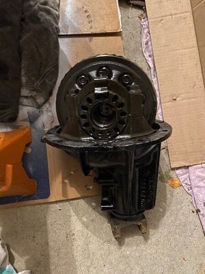

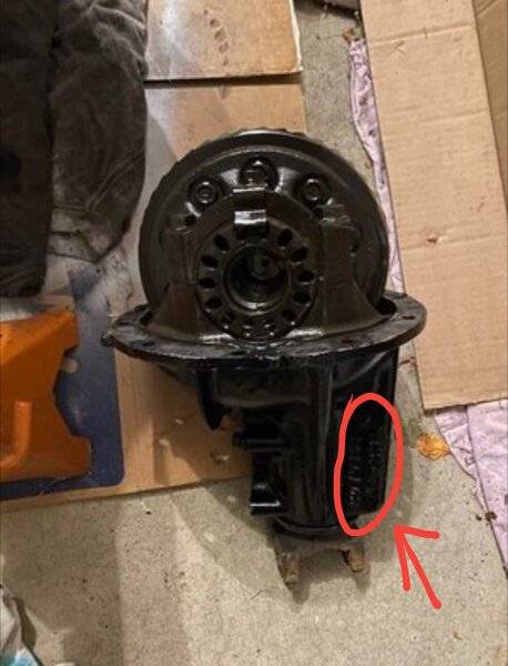

Just LOOK at it a Minute before typing. Look at how much ring gear is showing out past the carrier flange. Look at how many ring gear bolt there are/aren’t and the odd casting shape between those bolts.
Yes I’d like to know the housing number also.

Early Mopars used a 741 (possibly few other casting numbers depending on year) that used an 8 3/4 rear axle center section that used a ring gear with an 8 1/4 inch bolt circle.
Any center section that had a sure grip used a 8 3/4 ring gear. So no sure grip for that gear.
Best bet will be to have Cass build you one or find a used unit ready to bolt in.
Also if you have tapered axles you will have another problem. The axles will be too long and will have to be machined on the spline end to get them to the right length.
The center block in the carrier is a different length from the open carrier to a Sure Grip.

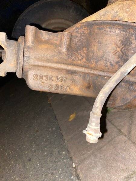

I had to go download a ‘65 Plymouth service manual and parts manual to see for myself. Very interesting. Looks like they put a 8.25 pig into the same housing as a 8.75 for just this application. Shows different numbers for the carrier so I’d be super interested to know that casting number. Maybe they machined the ‘741 casting differently? Came in 2.93 and 3.31 ratios only.
I have a 62 Dart with a 318 poly, auto, 8 3/4 housing, 741 case, no Sure-Grip.

Before '65 I see no trace of the 8-1/4 version. There's nothing wrong with the tapered axles either. Just need a relatively inexpensive puller or swap the drums so they aren't swedged on any more. I'd just find a sure grip pumpkin in the ratio you want and drop it in. Dr Diff will do right by you of course but you'll pay for that. My 3.23 sure grip pumpkin cost me $325 on facebook, seems unlikely you'll get out of it that cheap if you get new stuff.
Good news for me, must be a 65 only thing.
