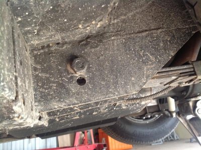

I am not certain which brand of relocation kit this is but here is a pic of my 63. The tire is 31x14. I can get some measurements if that would help you.

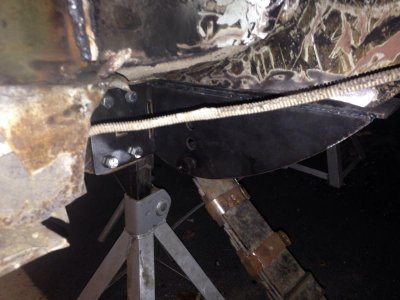

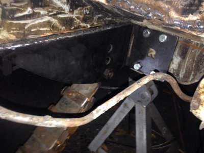

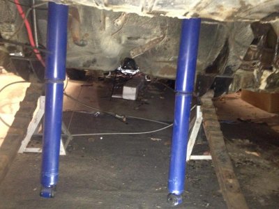

This is my 65. I think the relocation kit came from Mancini. Moved the springs into the frame rails.
Don't put the spring pads on until the frame work is done. Small differences depending on where the front spring boxes are located. Most important make sure the rear of the car is supported in at least 3 places on each side, shimmed and dead level. Your door gaps will thank you.

I was alone in the shop tonight so could not get center to center. From outside to outside was 39.25 inches (99.69 cm) and the springs were 2.5 inches wide (6.35 cm).

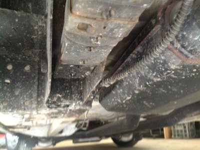

I just did my 65. Us car tool makes a kit for early b bodies now. I just bought the front hangers. These bolt in then you line them up true and weld.
Takes a lot of guess work out.
Hopefully these are turned correctly

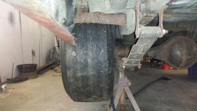

I am curious to ask why you are moving the springs ? Not trying to be smart but I was just curious if you are doing it for the looks of the bigger tires or for the performance part of the bigger tires for good hook ? I only ask because depending on how fast you want to go you can get good hook on tires that fit in the stock wheelwell. Course you may just want the awesome look of the bigger tire ? Or is it a race car that will need a very big tire ? I have seen stock eliminator cars running easy 9's on just 9" slicks. I have stock wheelwells and only run a 9" tire but thats all I need for good hook running 10's. But as I said I am not trying to be smart or anything I guess I am just wandering how you will be using the car going to bigger tires. Thanks and good luck. Ron

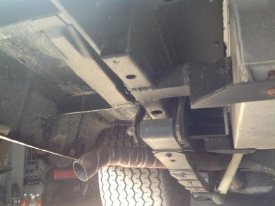

I know the is an old tread but I’m doing the same relocation in my 65 Belvedere and I see tail pipes are pretty snug between spring and gas tanks what size pipe are you using on this aplicación thanks and happy holidays
2 1/2" will work if memory serves correct according to TTI exhaust. I have recently been told and have seen pictures of 3" TTI tail pipe sections used with stock gas tanks and relocated springs/ mini tubs. Some clearance issues where addressed including bending of the gas tank flange and shimming the hangers. I'm going to try to use the 3" tail pipe sections myself, hope it works.
