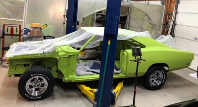

Restoring my '69 Charger from scratch... I have only the rolling chassis on the ground ( 440 engine, 727 trans, ESPO XD suspension, 8 3/4 rear-axle installed -- no doors, hood, trunk, glass, etc.. ) and wanting to measure for a new Strange U1699 3" driveshaft (1350 U-joints)
But from what I am told, I need to have a fully loaded car before I can make this measurement. All weight added... As you can see, the rear end of car is off the ground quite a bit now. ( Note -- the lift is not holding up the car )
Anyway I can cheat and load the car somehow with weight to measure ? I'm wanting to get the driveshaft installed so I can put in my TTI exhaust ... seems you need the driveshaft installed first before putting in the exhaust, to make sure no interference issues.
Any hints / ideas... ?

Not easily. I know my car came down 2-1/2"-3" while assembling it and and weight.
If the 440 is mounted in the stock location, the 727 has the standard 18 1/2" tailshaft & the 8 3/4 is mounted with stock springs in the stock location.... The stock drive shaft measurement should be fine.... That is 52.07....

I did notice that the driveshaft shaft distance increased about 1/4" when I went from no load to letting the tires down on the ground.
I talked with Strange Engineering this morning & they provided me with no help as to whether the distance increased or decreased with a fully loaded car.... they just said it "changes based on weight." :(

i did a driveshaft measurement for my tko500 installation on my 66 and the instructions do say to have all the weight in the car as it will be driven
see Step 1 for reference:
https://shiftsst.com/pub/media/wysi...00100_Driveshaft_Measuring_Procedure_RevB.pdf

Thanks.... that matches up with the information from Strange.
So guess I need to get going on finishing the car & adding the body panels, doors etc. so I can get the driveshaft & exhaust installed !
The only problem with all the weight in the car is how can you get under it to measure what length you need. Unless you have a 4 post lift and weigh about 100lbs. your not getting under that baby to measure anything. And if you get under might not be able to get out.
I think Wild RT nailed it, if you have the motor in stock location, stock position of the rear axel, a normal car 727, the OEM length driveshaft is fine. Doesn't matter if you've gone to the 1350 U joints. It's U joint CC dimension that counts.
