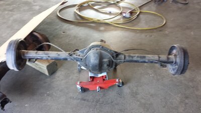

Exactly what I'm doing. If it was easy everyone would be doing it. If you have the money to buy a new complete rear why bother. I don't have an extra $2,500 laying around for a rear when I up to the challenge and I can do the work myself. Do you have the time or MONEY. It's not as hard or expensive as some might lead you to believe.

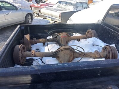

I just picked up two rears this weekend. One is a Dana 60 full floater out of a 71 dodge motor home with low miles for a LOT less then you might expect. I'm going to narrow and build the rear for a 63 Sport Fury Factory Super Stock project to take a beating with a 545 cubic inch engine in front of it. I had a 64 Polara Ramcharger back in the late 70's early 80's. The first run with a new 440 engine at the track after the 426 bought the farm I broke an 8-3/4 rear. I replaced the 8-3/4 back then with a Dana I put together. IT has been done before. There was no internet or anyone at the time to tell me you couldn't or shouldn't do it. I didn't know any better because I didn't listen then and I still don't listen now to the naysayers.
Last one I had done cost me $500 to shorten. I bought short axles for $200, used 8 3/4 housing ends for free. I put new bearings in it but used the original gears and they setup well with the original shim packs.
I am tempted to make my own jig if I shorten another one. Paying someone to shorten it for you I figure around $1000, depending on your scrounging skills.

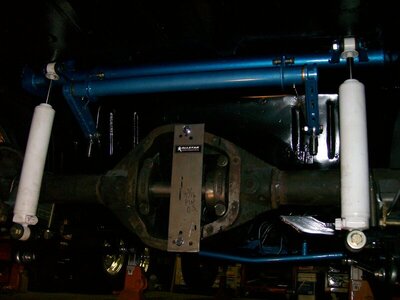

The snubber issue can be beaten by using Cal Tracs or welding a reverse snubber to the floor pan that contacts the nose of the D60 housing.

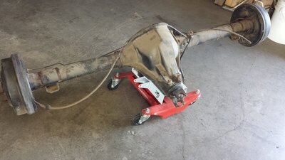

If it says "60" like in the pic its it's 60. My car and my sons Turbo car both have Dana 60's that started out as 8 lug. Torch the brackets off. Put a 9" cut off wheel (Lowes / Home Depot) in a miter saw. You'll need to shim the tube up on the saw base with wood so the tube sets square on the table. Leave the tubes as long as possible. There isn't a lot of length left for the long tube (pinion offset). Once the ends are cut off you can set the tube on the saw without the wood to make the final cut. It cuts square and clean. Just take your time. My sons car we measured the back lash before disassembly. It was .007". Just added a spool, ends, axles. Never even pulled the pinion. Cars been 9.55 on the original R&P.

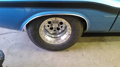

Same here. Mine was an 8 lug 1 ton truck rear axle also. Changed everything but the housing. Now has ultra lightweight spool, 40 spline gun drilled axles and 5/8" studs.
