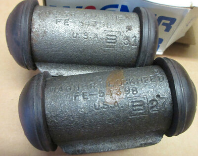

First to arrive - today, in fact - were rear wheel cylinders from Central Jersey Motor Parts (I was delighted to
find out that Jack is still in business up there - I can remember doing business with him in Jack's Auto Parts
days in the early 80's).
They ship FAST and it's packed WELL. Simply couldn't ask for better - and so, here's the rear wheel cylinders,
complete with required USA stampings:
Wagner-Lockheed, eh?
