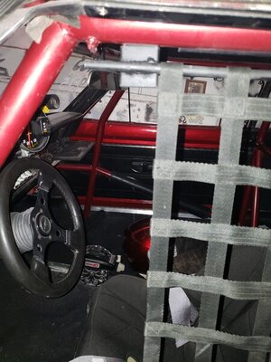

Yesterday after work I pulled my rear shocks to look everything over. I looked forward and saw light coming through the front of my collector on drivers side.
A 16" piece of slip on header tube was gone.
I decided to drive back to the track and look along side of the road.
Got all the way to the track and the manager was just locking the gate. I asked if he saw the pipe. He said he did but didn't remember where. He let me in and I found it on the side of the return road.

Window net not latching for a first round.

Screenshot_20210523-081657_Gallery.jpg Screenshot_20210523-172110_Message+.jpg 20210524_191643.jpg 20210524_194500.jpg 20210524_194551.jpg
