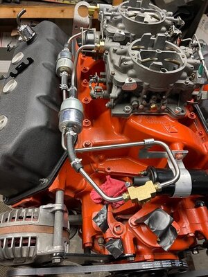

Today I attempted to install my new fuel lines from INLINE Tubes onto my 67 Charger Hemi engine, which is on a stand. I attached the lines to the carbs loosley, attached the rubber hoses to the fuel filters and the two fuel lines loosley to the "T". I also had printed out some referenced photos from online posts of other 67 Hemi engines.
I couldn't get the T to be at the 90 degree position to connect the fuel line to the fuel pump. see photos. The T is off center and the fuel line from the fuel pump is not lining up. I took it apart a few times, changed the rubber hose sizes, thinking I had the dimensions off but to no avail, the T is still off center to connect the fuel line to the fuel pump.
Any suggestions on going about this installation and getting a good result? See attached multiple photos.
Fuel lIne T off center.JPG Front view of fuel line T.JPG Fuel line off center to T.jpg Fuel pump connection to fuel line.JPG side view of fuel line to T.jpg top view of fuel lines.JPG
The long piece that connects to the tee looks like it is bent wrong. All the pictures I have seen seem to have 90 degree bends, but your line doesn't.

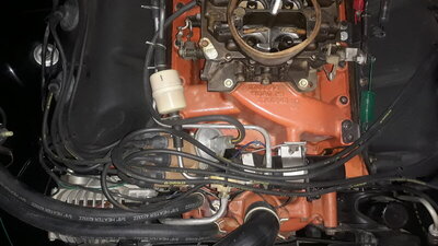

each of my rubber fuel line pieces are 2" in length
As for where they came from I have no idea ( I bought the car done )
Here is a 66 tube kit I 20 to 25 years ago, no tee.View attachment 1138137
FRan, I can see the difference in the tube bend and that is the problem, the aftermarket stuff could be made better if they had had the original bend setting in their equipment. WE buy this stuff thinking theu have it right and they don't. Thanks for the photo.

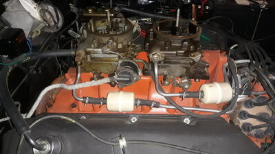

View attachment 1138447 View attachment 1138448
Thanks GTX690 for taking the time to send me your photos. Much appreciated and understand your thoughts on the tube length. I changed mine out a few times thinking that is what the problem was but I believe it is the bend in the new lines is not correct. I will have to re-bend my self and get it to line up.
