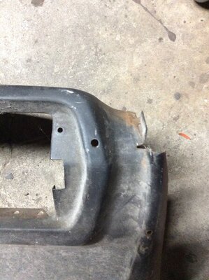

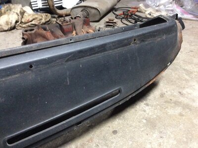

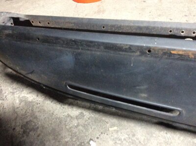

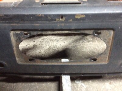

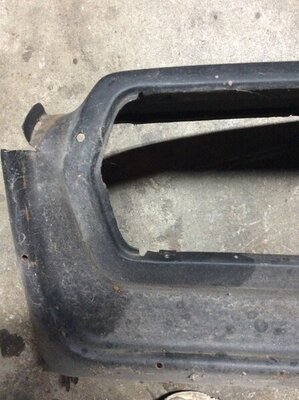

How many speed nuts hold the upper dash pad on and do you have any pics? I’m considering taking mine off and having it restored. Just Dashes currently has my lower dash pieces in line for restoration.
I count 7
EDIT: So sorry. This dash is from a 67 Satellite. I should have read the post better.
F1E4E0AF-0FD1-4800-AF40-96CC1FD65766.jpeg 4EA1BFF3-C1ED-45DA-981E-5C08AB6418F1.jpeg 423648F9-C445-4DEB-BCEA-57755AC4CD37.jpeg F4A34ABC-3EE4-4166-9F8F-2AB3E84878CE.jpeg 7B3EEDA5-B8A2-4A38-BDD0-E31E5D3D710B.jpeg
