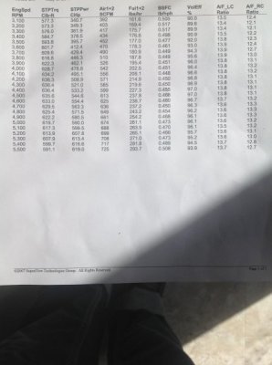

I did a 512ci stroker a few years ago from a 400 Chrysler. I had the engine Dyno and it was running a bit leaner on the right side over the left. Just wondering if this is a normal trait for a duel plane intake on bb mopar because of different intake runner length? Being on a dyno this was obviously at wot. When I check the plugs they definitely look like the right side runs leaner. Just wondering would it be worth offset jetting the right side to make them the same?

Tell us about the build and show us the dyno sheet .

And there is the problem. Unless he has a reading for each cylinder, it is simply an average of 4 cylinders. Could be one cylinder.
Need EGTs

400/512. Edelbrock performer rpm, trick flow 240, crane hydraulic roller 252/258 @ .50, 2 1/8 Tti headers, Holley 850 Xp, hs roller rockers.
