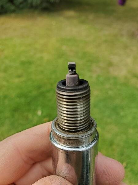

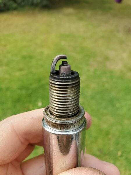

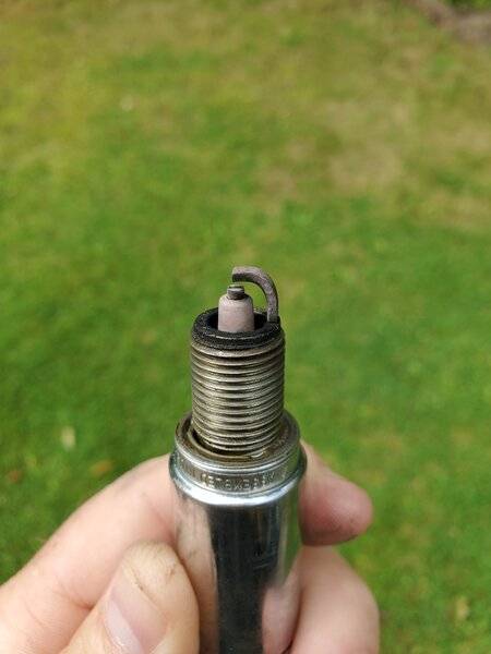

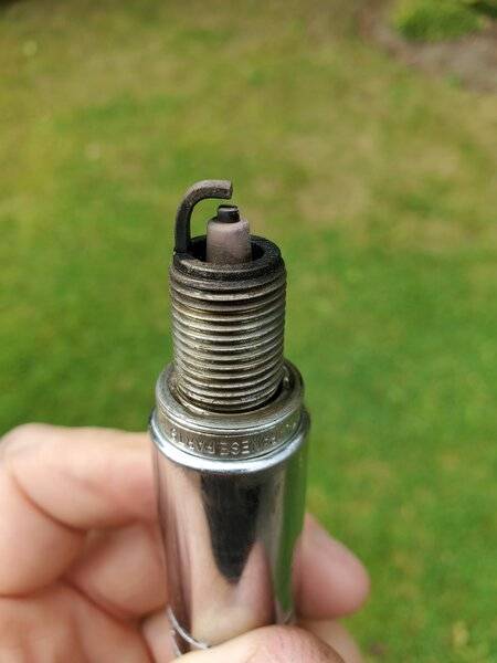

Those are great numbers for a street stroker and they closely mirror what I got with my tf240 with Holley street dominator single plane and 499ci. Unless you are getting craziness like white plugs on the passenger side and fuel fouled on driver side, I would not worry. If you want to investigate further and you have headers you can use an infrared thermometer on each exhaust port to get approximate EGT.

How does this look to you guys?
