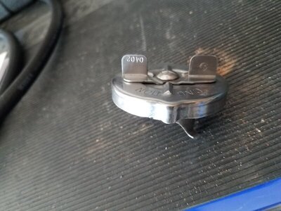

I started cleaning the one that came with my car and was able to see the date code 0402. It's a Stant but i'm wondering if they weren't a contracted supplier to Chrysler plants. I'll put up some pics once my internet service decides to play nice.
Looking for P/N 3466825 myself or a Stant. The one's I keep seeing says "Pressure vacuum", not "Open Slowly".
Here's the cap that was on my 72 Charger. 0402 means 02/09/72. My car built on 04/29/72. Took me 3hrs to clean this thing. Special thanks to RRGTX and the ODZKing. Due to your input i learned a lot about gas caps and now know how to read the date codes.
