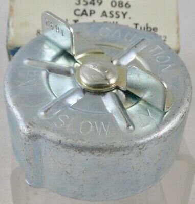

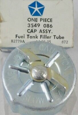

Can anyone confirm the correct (non locking) gas cap on both a 72 and 74 Charger? I'm planning on purchasing these but the catalogs show an unexpected range of items. The one on my 74 looks like a red shop rag which i assume may be factory if built on a Friday. The one on my 72 is pictured and reads Caution Open Slowly
i had seen that but wasn't sure if it was correct. Did they really say "Made in Mexico" on it? Classic Industries sells a cap that says Made in Mexico while Year One has a similar cap that doesn't say it. Then there's this current ebay item.. that claims to be a 72 cap...part number 3549086. Your thoughts?

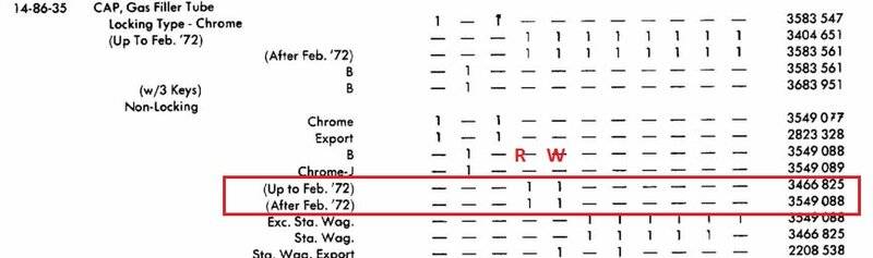

Book calls out 3549088 for production beginning March '72;
Don't see 3549086 anywhere. I use Stant caps, 10807 should be the later double latching cap.

I will go one step further and list the correct part #s as follows.
Tank (to 3/72) 3404951
Tank (after 3/72 - includes 1973) 3642103
Tank (1974) 3726425 (has the bulge)
Cap (to 2/72) 3466825
Cap (after 2/72)3549088 supersedes to 3780670
Cap (1973-4) 3549087 supersedes to 3726407 to 3906604 to 4002577(same as 75-77)
As far as the 086 #, I can't find that anywhere. The 4 digits are a date code BTW.
Hope this helps someone.

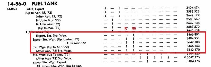

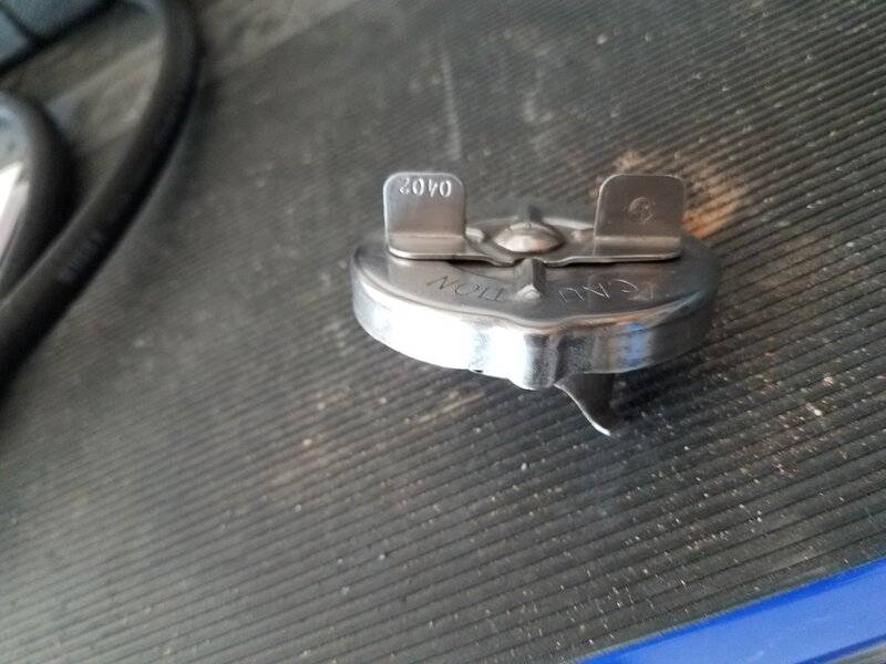

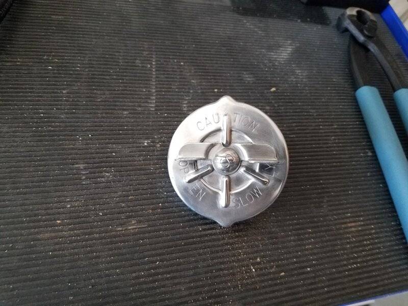

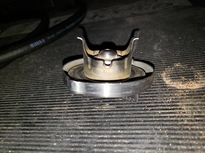

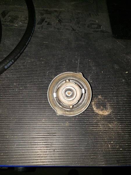

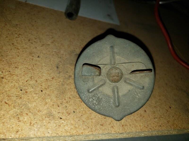

I started cleaning the one that came with my car and was able to see the date code 0402. It's a Stant but i'm wondering if they weren't a contracted supplier to Chrysler plants. I'll put up some pics once my internet service decides to play nice.

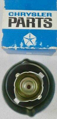

Looking for P/N 3466825 myself or a Stant. The one's I keep seeing says "Pressure vacuum", not "Open Slowly".
Here's the cap that was on my 72 Charger. 0402 means 02/09/72. My car built on 04/29/72. Took me 3hrs to clean this thing. Special thanks to RRGTX and the ODZKing. Due to your input i learned a lot about gas caps and now know how to read the date codes.
