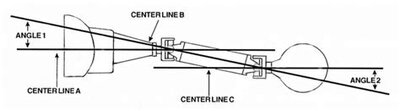

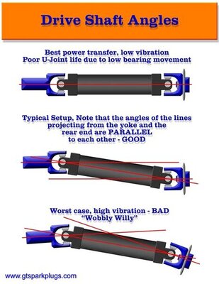

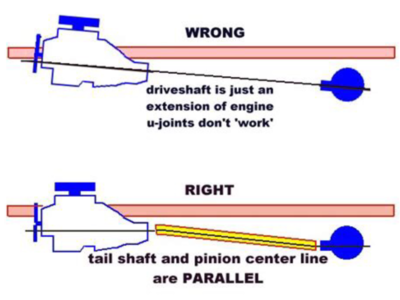

You measured the angles of the engine and rear, but not the height. You need to measure each joint angle separately from trans to driveshaft, and driveshaft to rear axle
View attachment 1277801 View attachment 1277802 View attachment 1277803 B77ECDF0-72C2-4A9C-98CB-A85837D2AEDB.png 6F5329E7-C349-4319-9A36-6C2FEC84D58B.jpeg F4891217-0999-4155-B7DA-0D248A2483DE.jpeg
View attachment 1277801 View attachment 1277802 View attachment 1277803 View attachment 1277804 View attachment 1277805 View attachment 1277806
I am convinced there is some problem with my angles, so perhaps I measured wrong. I will try to set the car up again and measure it again. I won't be able to do that until tomorrow night, but I will respond here with the results.
