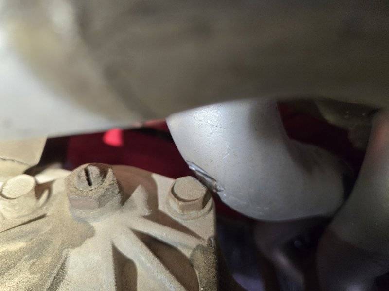

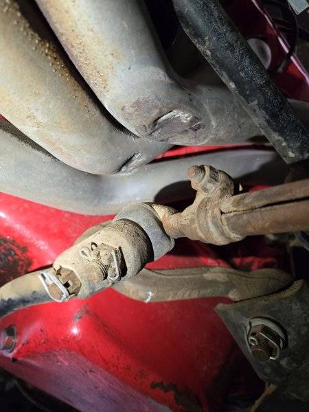

Fixed! There were a few spots on the steering link that had rubs, so I got the trusty air hammer out.
Took it for a drive to warm her up. When I got back I was still getting a slight rumble that I could feel through the steering wheel. Got the hood up and looked some more.....and the header was hitting the steering box. A little more air hammer and no more noise. Thanks for the help!
