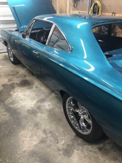

I’m not real sure exactly what I have then. Kinda worries me that I was told it was a charger dash but I’m not sure. I’ll have to get busy on my interior as my car has been out for repair for over a year. Thank you very much for your help. I’ll add some pictures next go round. My car is a stunning early darker LL1.
The low back buckets look like 68 charger. Maybe I repair what I have as such. I’ve already blown my budget.

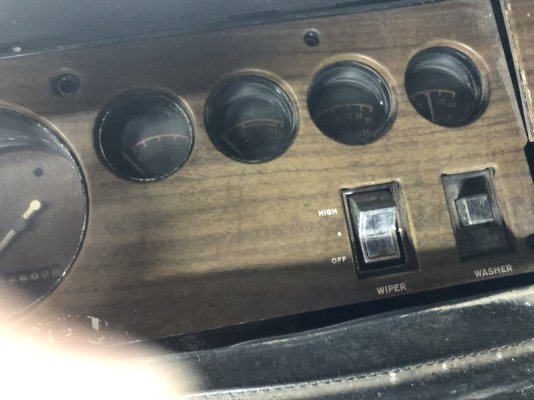

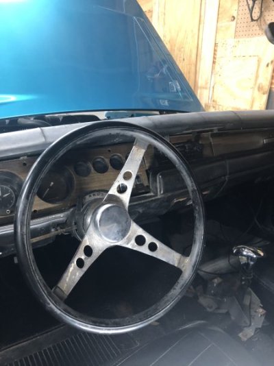

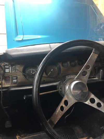

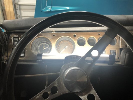

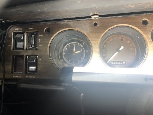

What you have is a 69 Charger SE cluster, Dash frame & dash pads....
If it were 68 it would have a small pop out plug below the fuel gauge... And those were all black plastic with vertical ribs
Regular 69 Charger & Super Bee wouldn't have wood grain..
70 wouldn't have a Hazard Flasher switch...
69 & 70 style upper dash pad 68-69 lower pads...
Can't see a heater control..
Looks pretty odd right below the radio bezel...
They hay have hack the rally cluster into a standard dash frame but I don't think that's the case..

I missed the part in your first post about the po changing the dash. Like stated above, you have a 69 Charger cluster in the car. But they didn't replace the metal dash, just cut holes to fit the rallye gauges?

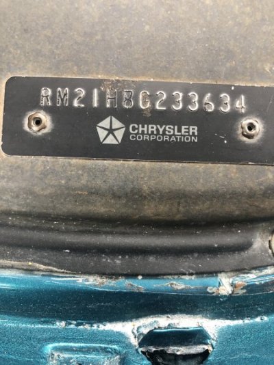

I’ll have to see how bad the metal is jacked up. The VIN is intact. The videos I see show the dash should come out fairly easy with the windshield out. I’m slow so this will be a long process but, I’m retired and this is my relaxing time. I’ll post finished product when I’m done but may reach out again when I’m in a bind. Thanks again.
Looks like Abdula the butcher hacked that frame to stuff it in.
