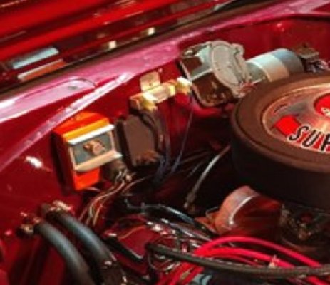

Not claiming any originality of course, but I've always done mine like this:
The ballast, regulator (swapped for an electronic one) and the
orange box fits nice right up under the body seam there.
Makes wiring a cinch too.
