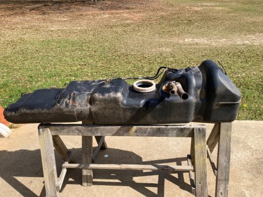

Removing the bed , or lifting it up, is of no use on this model. The four door cab goes way over where the fuel pump assembly is in the tank itself. I have dropped one end of the tank down and can get to the two, one large and one small, fuel filler hoses. They are about 20 inches long and no matter what small hose I poke in there, it hits something like a fuel screen right at where the hose and tank meets. Does the tank have one of those anti fuel theft screens in there? I may have to lift up the fuel pump assembly a few inches and get a siphoning hose in there to pump out old fuel.....Thanks all....
Another option is to disconnect the line at the fuel rail and connect a hose there.
Then jumper the fuel pump relay and pump it out somewhere.
True but he's replacing the pump because it doesn't work. The Delphi or Carter will be just fine.
I got the tank out with much 'persuasion ' on my part. The two filler hoses attached at the tank does indeed have a screen inside and you cannot get a hose in there to siphon out fuel. Raised up the pump assembly a few inches and got a hose in there, pumped out over 15 gallons of stinky gas. Pulled out the pump and the pickup screen was mush, sitting in ethanol gas all those years will surly make rot rather quickly. But, with that big ole pump removed, it was easy to get my arm in there and clean out the plastic tank real clean. Now to order a pump, anyone know if this is the 22 or 24 gallon tank, seem there are different pumps.....
