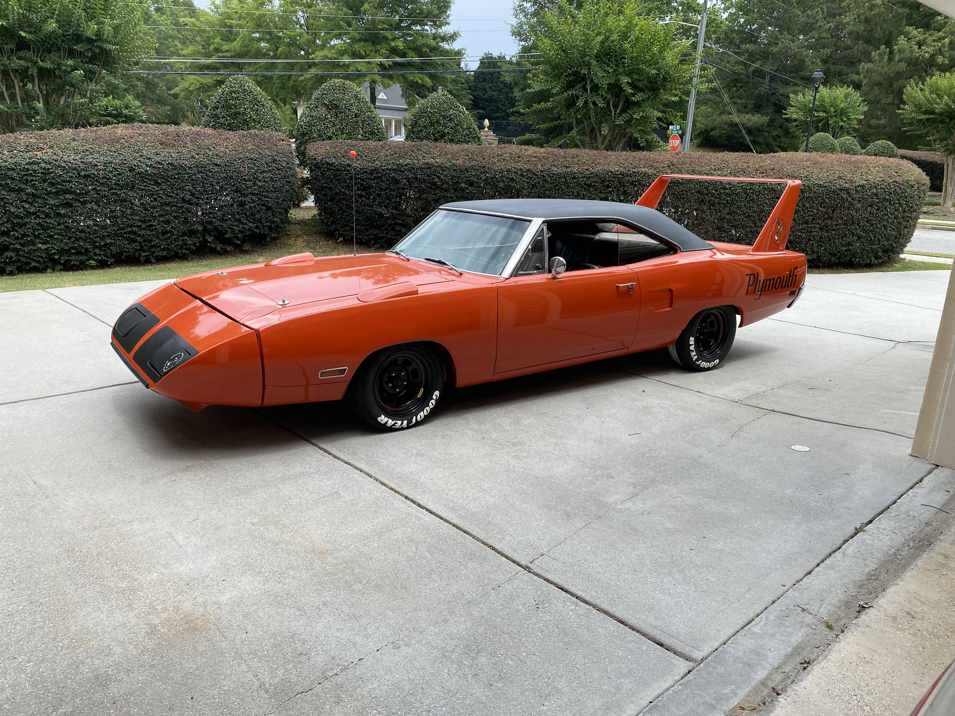

Rotisserie restoration of Satellite to Superbird.
About this Mopar:

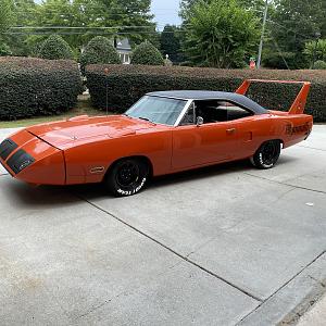

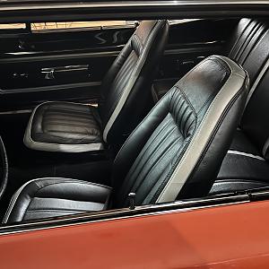

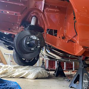

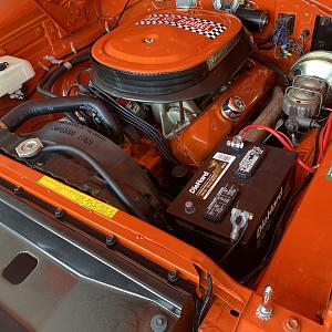

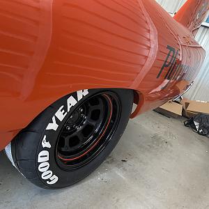

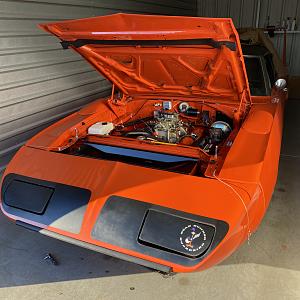

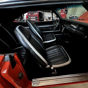

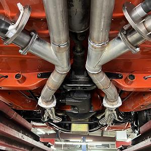

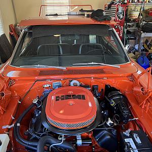

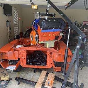

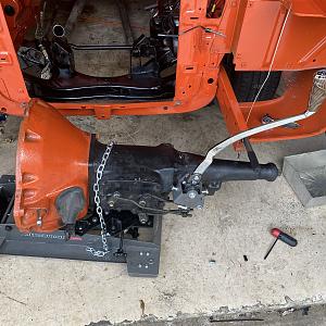

After I got the 440 3X2 installed it occurred to me that because this is a tribute, why not a Hemi? So out goes the 440 and in goes the 528. A bit of a squeeze but nothing major. Exhaust headers (TTI 1.25) were a serious challenge but done. 3" exhaust system with electric cutouts. New brake booster installed as the larger one would not fit next to the Hemi. Replaced the tranny with an 18 spline, Mickey Thompson ET's (added Goodyear raised white lettering )....275X50X15's with no room to spare (but didn't have to roll fender). New RTX, Dakota Digital dash. Replaced the bench seats with custom reupholstered buckets along with new carpet and seat belts, and yes an original 8 track AM/FM factory tape deck.

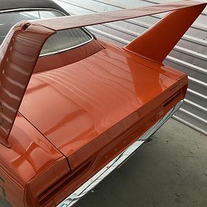

It really doesn't look like a tribute, where did you find the nose and wing?
The nose is original metal and the wing is original aluminum. Biggest investment by far. Found on the internet, both on eBay 3.5K for the pair.
With you on the Mickey Thompsons raise white letter's. Also the bucket seat's with console make's it look like the car's I remember. With the console shifter. Grate work. Keep it up looking good. :thumbsup:
