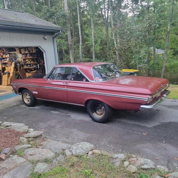

1965 Belvedere , took 4 years of waiting for parts during the covid debacle

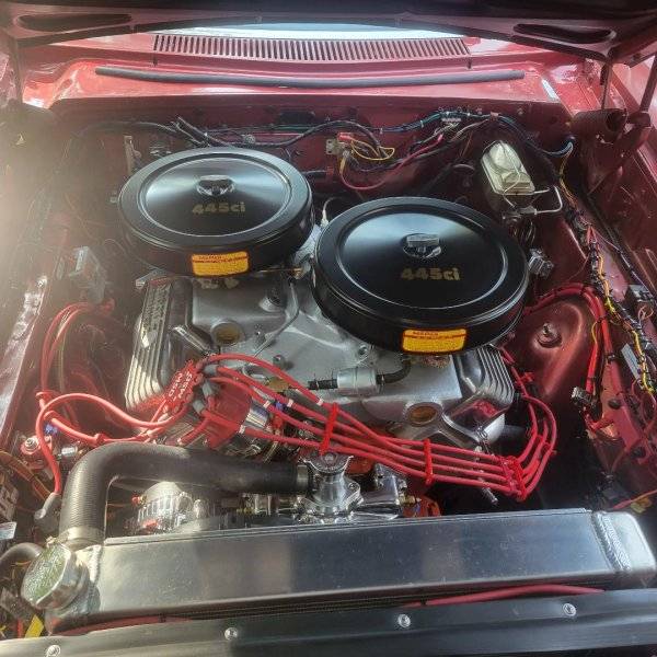

1970 440, steel crank, boring 030 over, full roller. cross ram from A&A transmissions. Eddy 750 carbs ( may later change to ATM Holley as $$$ permits ) All machine work and assembly by Mason's Racing Engines in RI. Due to my physical handicaps, moved a lot of the wiring under the hood. Trunk mounted battery.
TTI headers, Bullet (special grind ) cam. Meizer(sp?) electric water pump. Electric fuel pump. Milodon 7 qt pan. Griffith radiator, dual fans. Hughes 2500 stall convertor. 489, 3:55, ( for cruise nights, for now). Hemi torsion bars, rear springs, Caltracks.
New fuel tank, electric pump & regulator ( usual parts). Braided lines, AN fittings throughtout.
