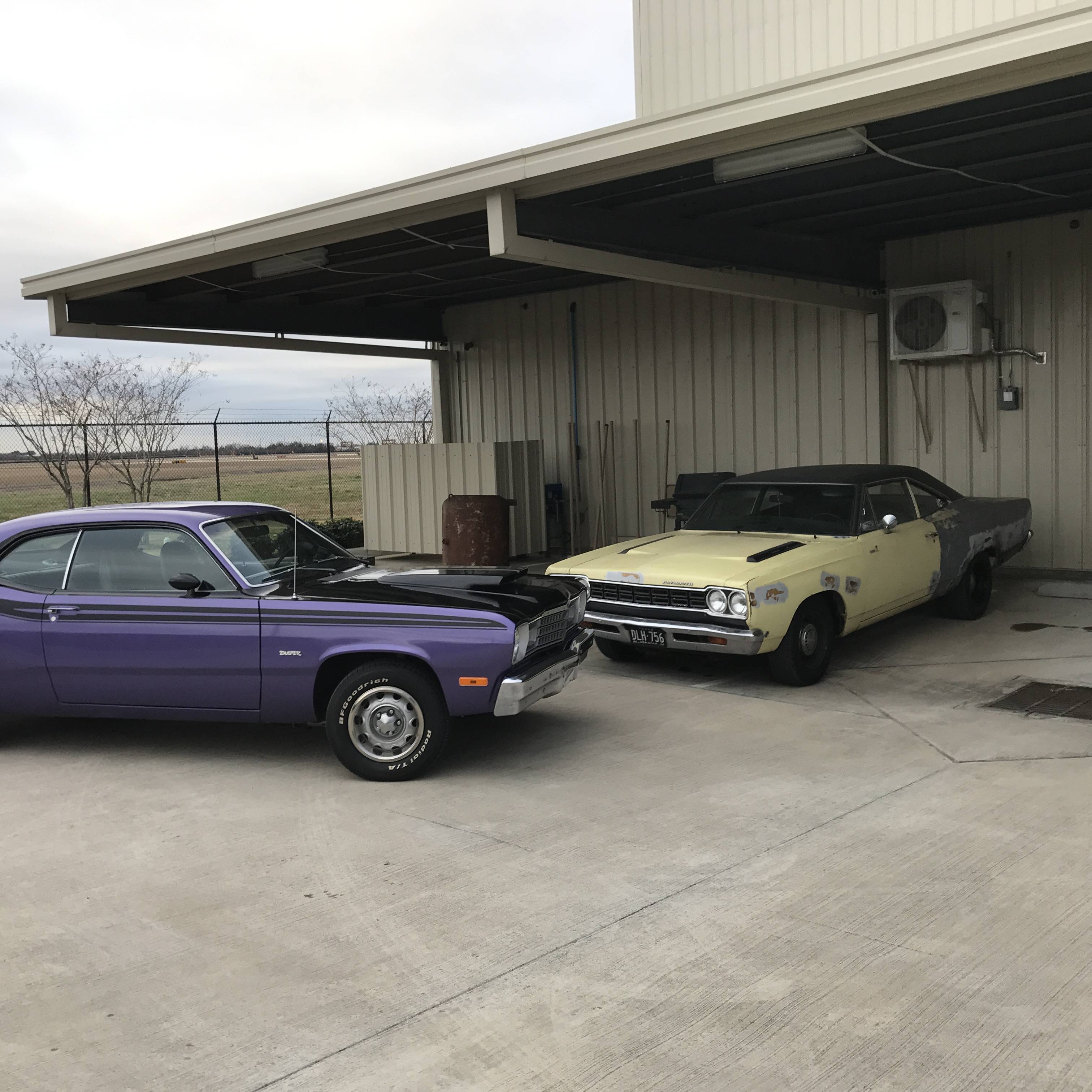

About this Mopar:

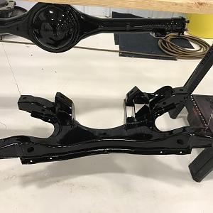

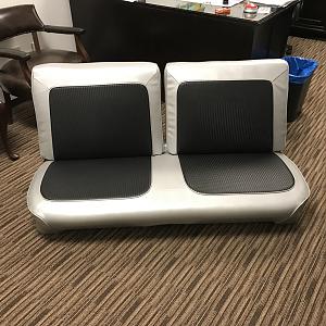

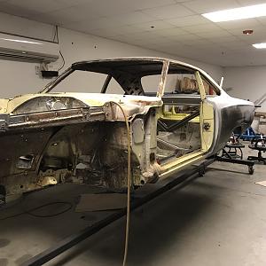

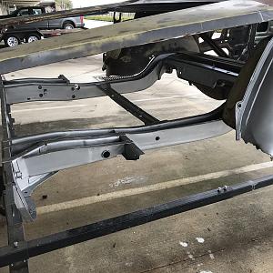

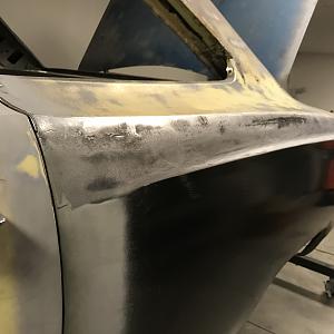

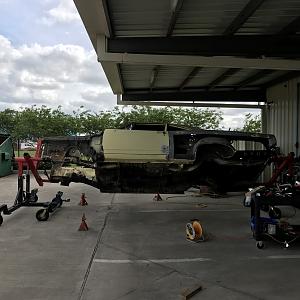

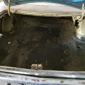

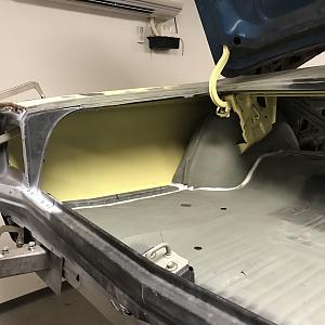

1968 Plymouth Road Runner Sunfire yellow, black vinyl top , silver and black interior. Was originally an automatic car but someone converted it to a 4 speed. I have replaced the trunk pan and have repaired the inner and outer wheelhouses. I am currently working on the quarter skin installations. Hope y’all enjoy the pictures. 19948152-B6CF-4486-9A18-A83DDE836C0B.jpegA09AA28B-4CBD-4FEE-89B0-B4980809DCFD.jpeg60815C19-20C2-4F46-B35D-34694D1780DF.jpeg1D90064F-B047-4D2C-983D-B8FA673F27E6.jpeg59148EB4-2955-4111-B67E-49052D79D131.jpeg2E26CBEE-A379-47DE-BFBC-83A279514040.jpeg88214E6A-60BD-40AF-8ECC-518426B0B9B2.jpegEEEA4122-BDE5-430D-83A8-EE1C3D3FCACC.jpeg021D18FA-F8C2-4D5D-949B-958BB5A51E83.jpeg82670F3A-C923-4887-8D3E-9BB49B6FB8E0.jpeg78A8DA77-8CBF-4E8B-9230-AC0BF33AF31D.jpeg14B42B6D-EC7E-4F80-B170-03CEB18E6964.jpegThanks. Here are some more pictures of the progress. Here’s my motivational poster thought some might like it

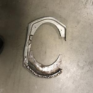

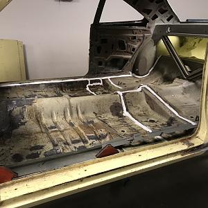

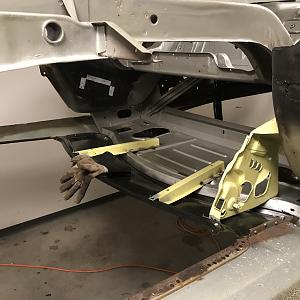

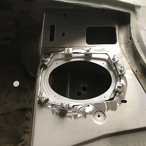

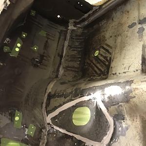

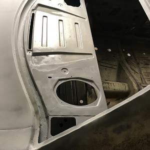

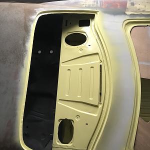

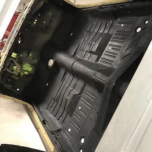

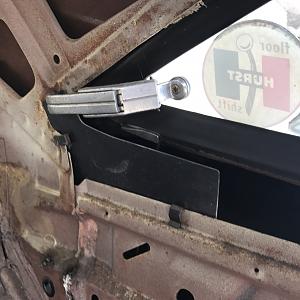

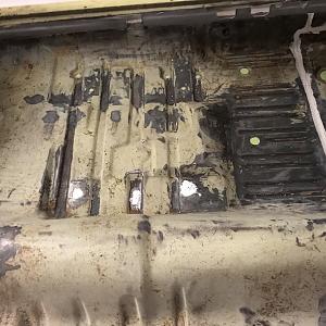

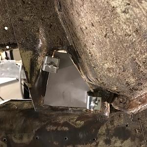

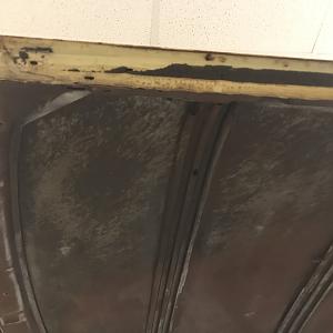

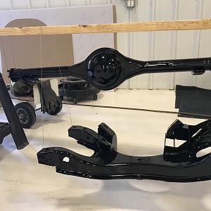

. Half way done with the restoration only 2 more Road Runners to install. Hers an update. Drivers side quarter skin installed. this is the last big piece to be installed. Thanks for looking 24E48059-8D1C-4047-B60E-4DC66586C03C.jpegCF1C2637-39EE-4579-ACC8-99515457B72F.jpegCF1C2637-39EE-4579-ACC8-99515457B72F.jpegB8364A75-72A2-48CD-AB09-3501F27F91DC.jpeg9E913FCC-93E7-4B53-867C-9CA9ADF3B720.jpegFDB1D925-5B1A-40E5-B5DA-0883059D1CB6.jpeg here’s a little progress had to fix the rear speaker cutout and started to fix the hatchet job on the inner fender well where the clutch s bar attaches. Closing it up going to put in a hydraulic clutch..Ok here’s a little bit of progress on the bird. Got a little paint shot. Re applied seam sealer to the floor pans. Cleaned and osphoed the floors cleaned the old insulation off the inside roof.. starting to work on welding up a lot of extra holes in firewall and engine compartment. Enjoy and thanks for looking. Here’s some pictures from today. Was able to spray the lizard skin sound deadner in the inside and sprayed a little yellow on the package tray

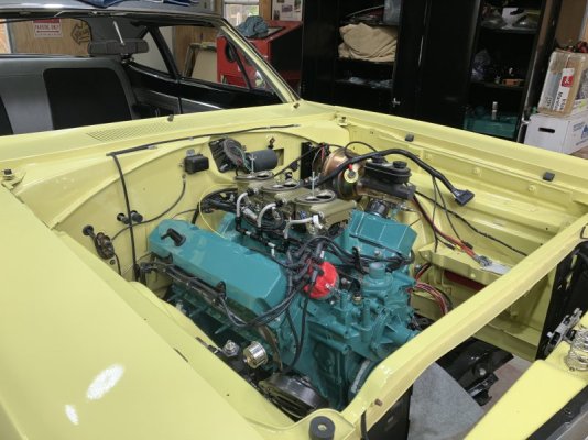

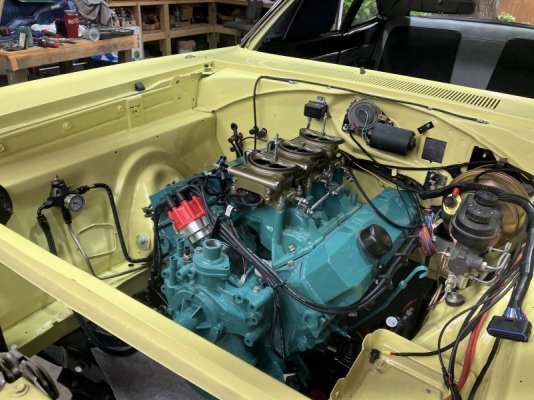

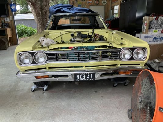

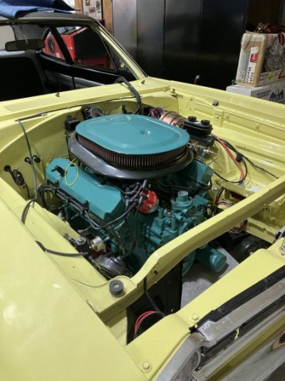

So the Bird is mostly finished, I’ve put about 45 miles on it since last week after getting the alignment, still tuning on the Fitech 6 pack but it’s going too make its first car show this Saturday . Heres some pics of the finished car! Thanks again for all the support!!!

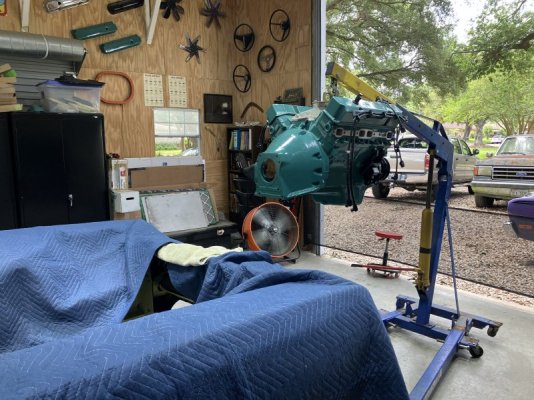

I plan on a 496 striker with the FiTech 6 pack fuel injection. 3:23 sure grip,vintage air,power steering and 4 wheel disc brakes. I hope that when it’s done myself and my best friend of 50 years will take it on the power tour

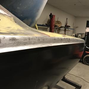

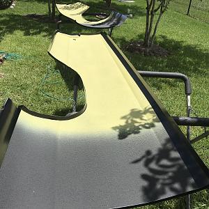

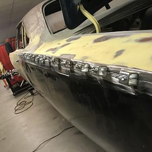

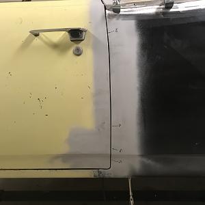

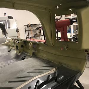

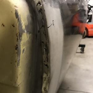

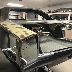

The quarter skins I got from Year One come up over the top.
Got the last two they had "scratch and dent" deal.
First skins I've ever done. Was surprised that they come up over the top of the panel.
That's were I'm making the seam, on top.
Is that something people do?
Haven't seen any before.
They also go around the door jam and down to the pinch weld on the rocker.
But the tail light end will have to be cut and modified.
My brother did the fitting on my car he left the piece that wraps aroung the front at the door and cut below the seam on the roof.
he's done many cars and lots of mopar resrorations
Yes, and we had to modify the back sections as well.
Nothing fits very well without some work to make it right.
I cut my quarters about an inch below the top panel line then butt welded it. It seems to work well. A lot of welding and grindin. But well worth it
