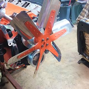

750 Dual feed Holley rebuilt and sitting on top of M1 intake w/ new fuel inlet and pressure gauge

stock 73 440 valve train cleaned up. new Holly dual feed fuel line with inline pressure gauge. Rear main seal billet aluminum bridge.
