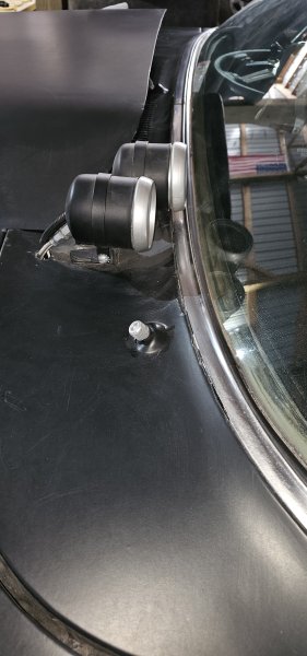

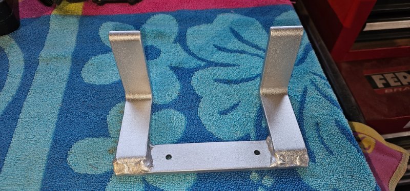

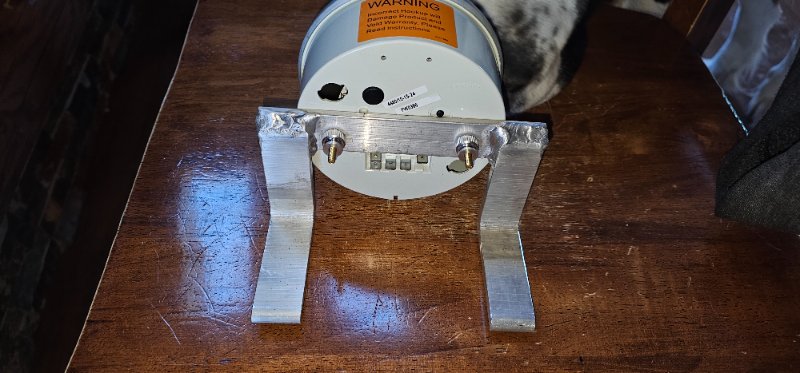

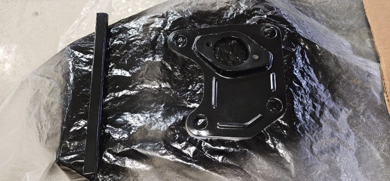

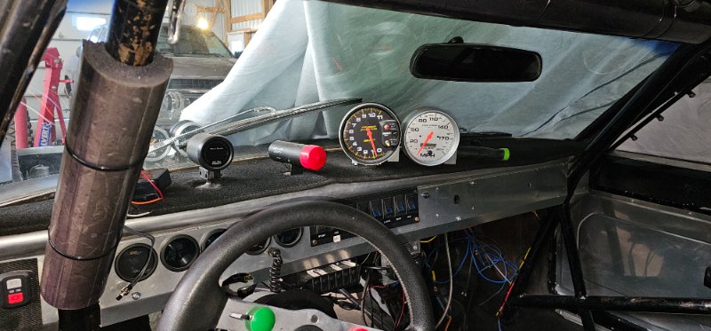

Installing a Autometer Pro comp Ultra light 200mph speedometer.Got the bracket made. Painted the bracket.

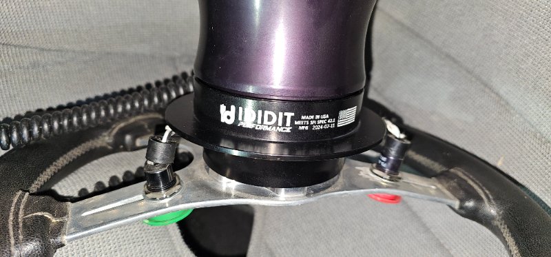

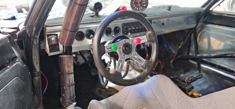

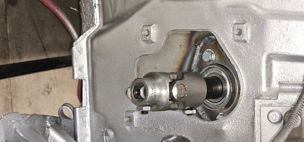

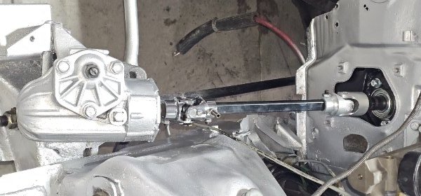

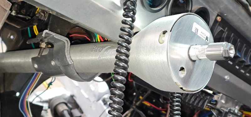

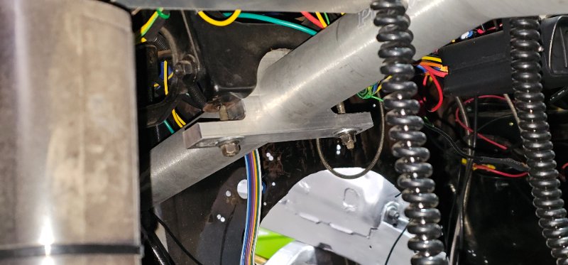

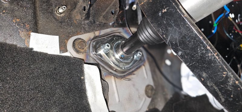

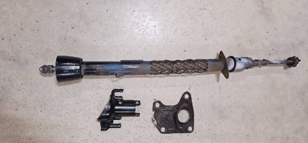

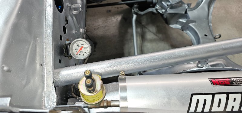

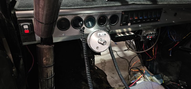

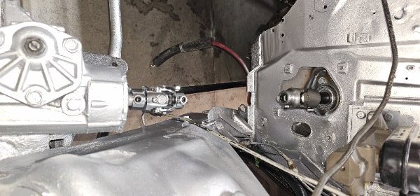

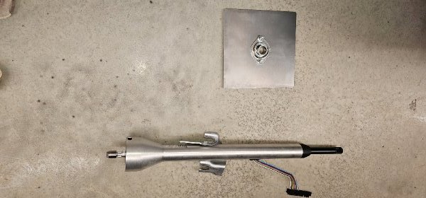

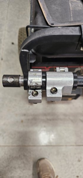

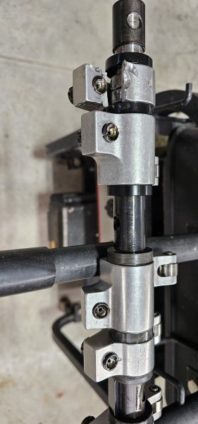

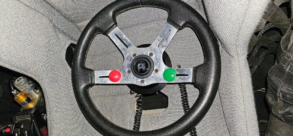

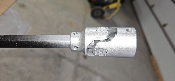

Installing a i did it pro lite steering column with DD shaft with universal joints at both ends. Quick disconnect steering hub and horn button.

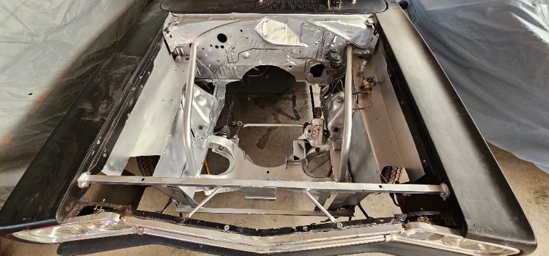

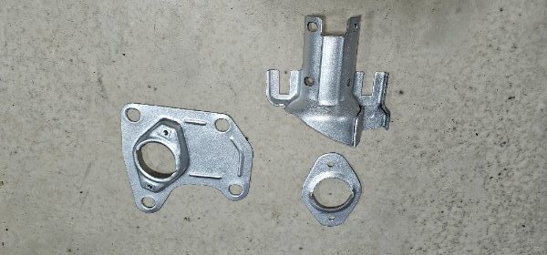

Painted steering column brackets. .Got a new oil pressure gauge installed.Also the new steering column getting installed soon.Steering column lower bracket made. welded new bearing onto factory bracket.. Working on upper bracket now.Upper steering column bracket installed.Painted bracket , steering rod and ujoint.Install finished.

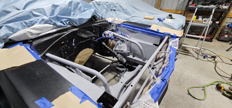

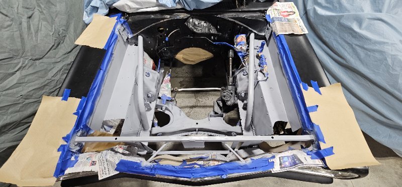

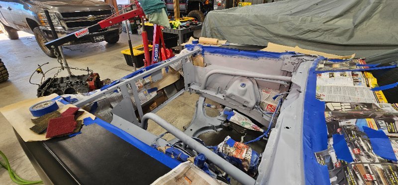

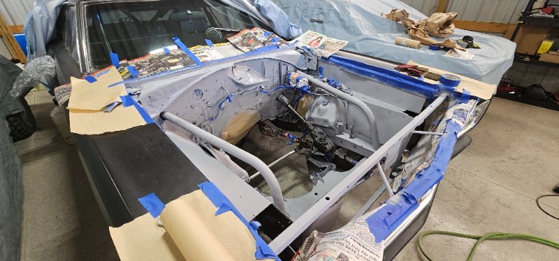

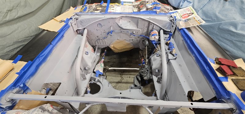

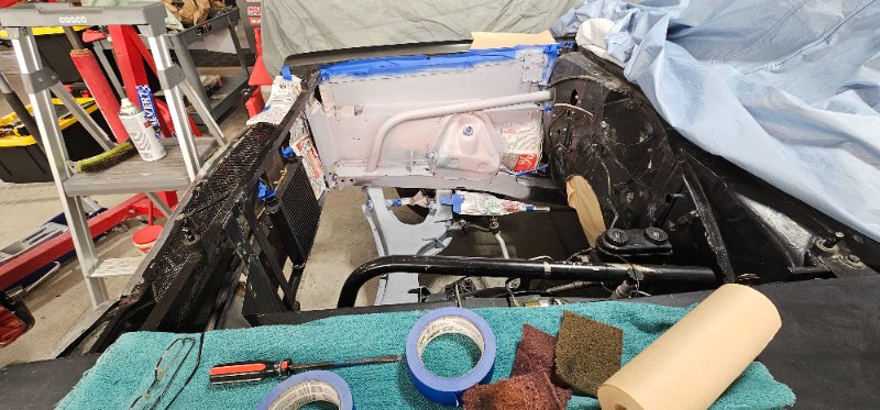

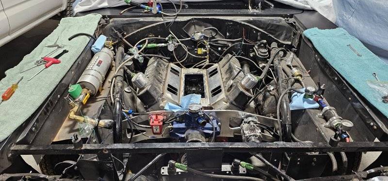

More sanding more primer then ready for paint.

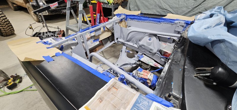

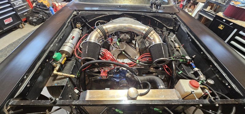

Engine compartment painted..

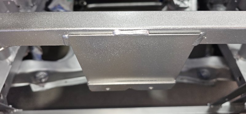

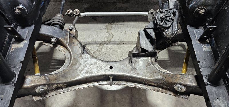

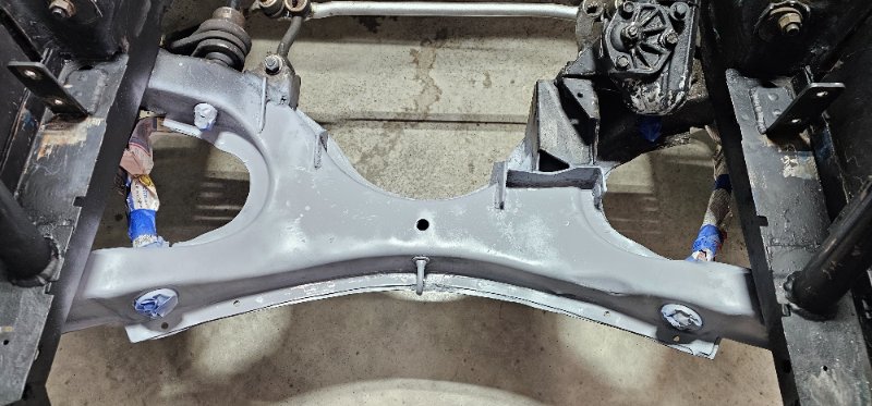

Scrapped alot of dirt and old paint off of the K member. Got some primer sprayed.

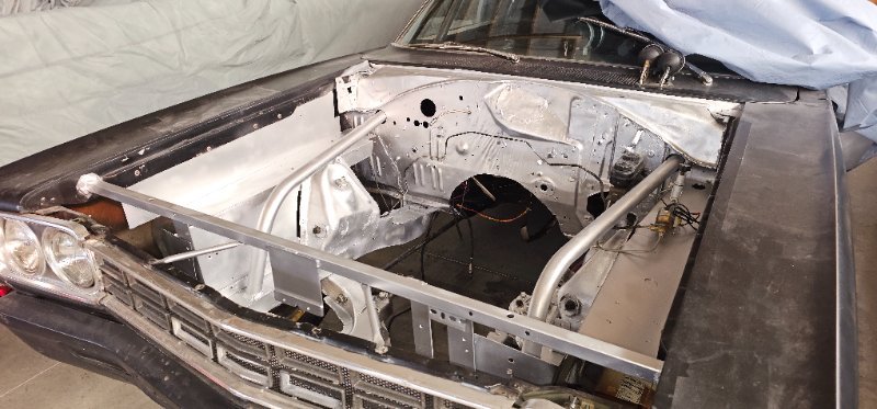

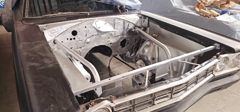

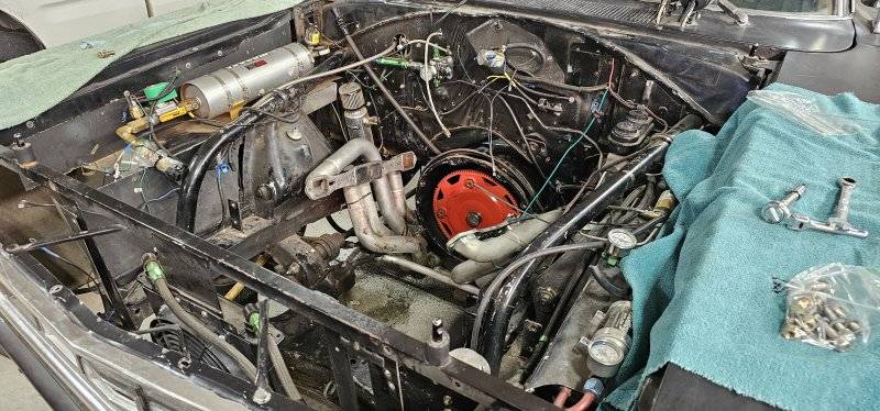

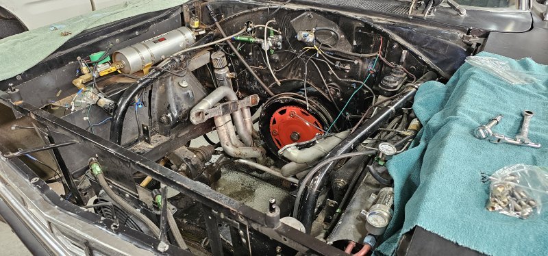

Engine is out now i can prep engine compartment for paint.

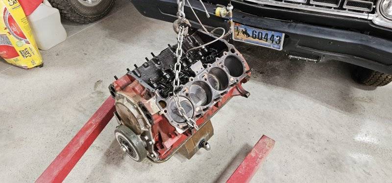

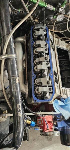

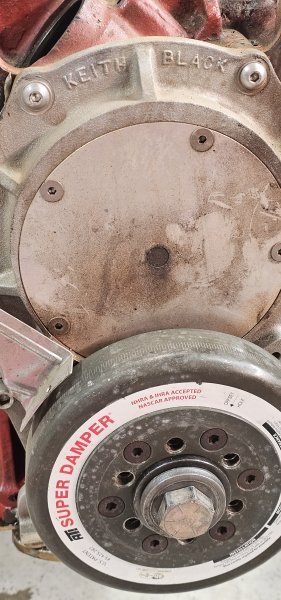

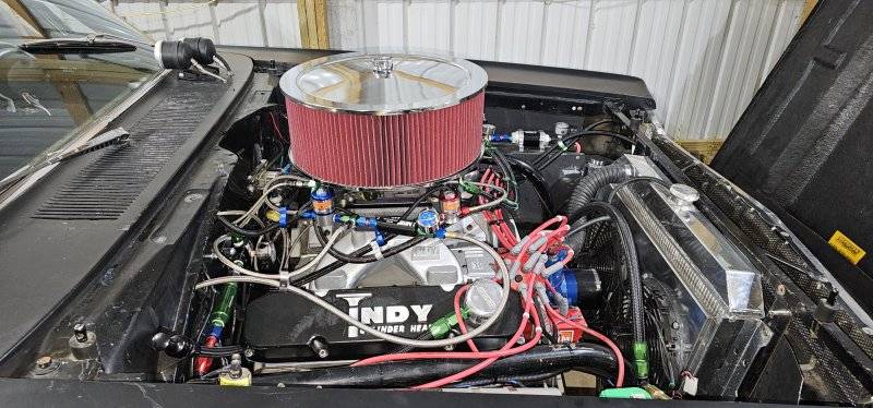

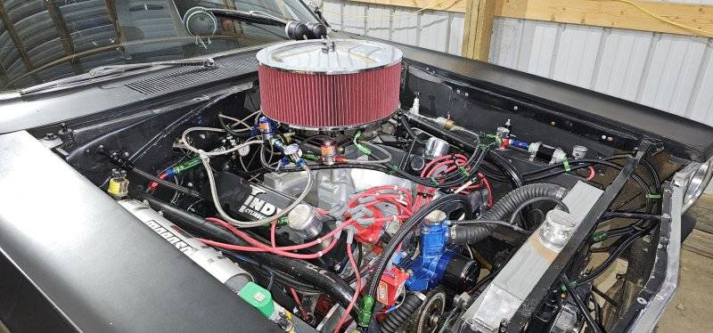

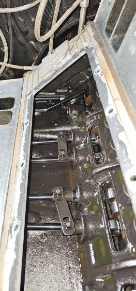

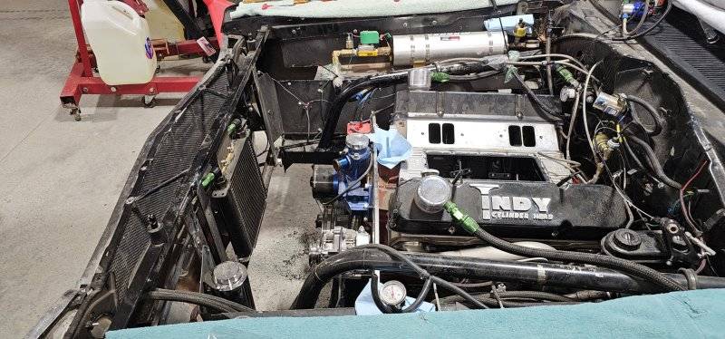

Getting ready to start a new engine build.Going to run a Aluminum Indy block and run the Indy heads that are on old motor.

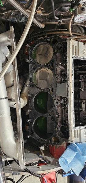

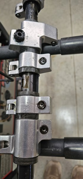

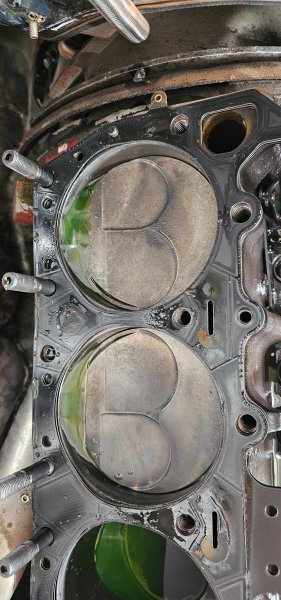

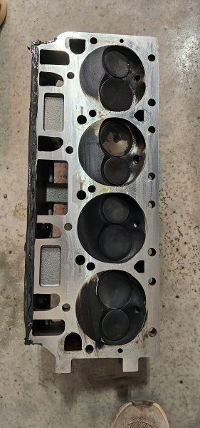

Lifter broke , bent push rod. Starting to tear old engine apart.Indy 440-1 Cylinder head with 2.25 intake valves.

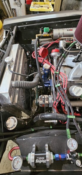

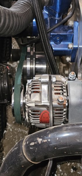

Got the alternator installed.

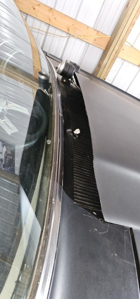

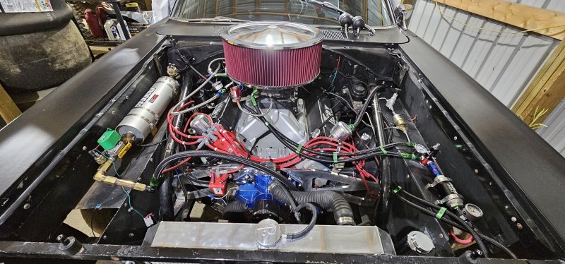

Got the headlights installed.Also
going to make a custom lexan hood scoop.

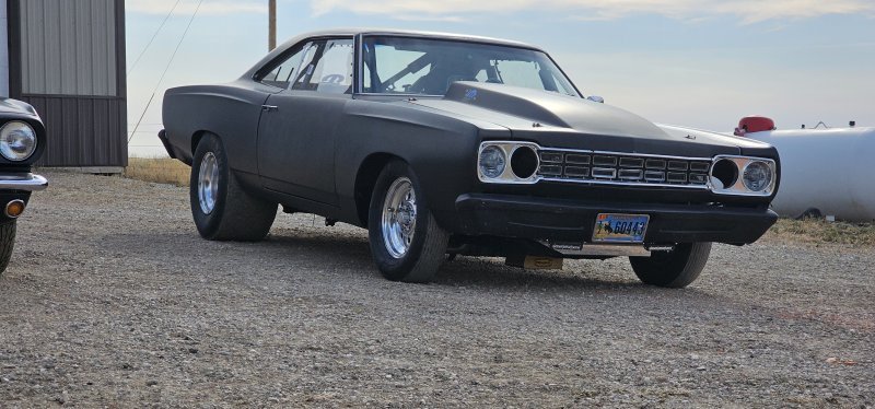

Hello , and thanks for checking out my car.. while it is driven on the street it is a Prostreet car. I have 2 cars with 5k stalls and big cams running on 112 octane gas. both cars are on the trailer more than on the street.. have the 5k stall in my mustang since 1998 and never had any problems.

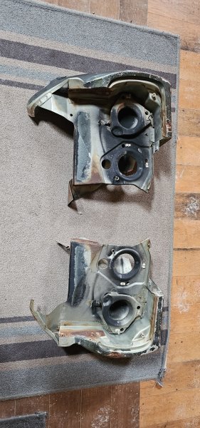

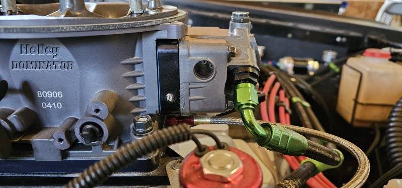

Dropped the car off at the tuners for some holley carb work and runs on the dyno.

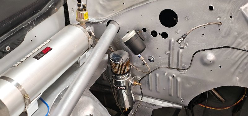

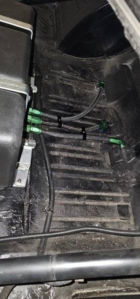

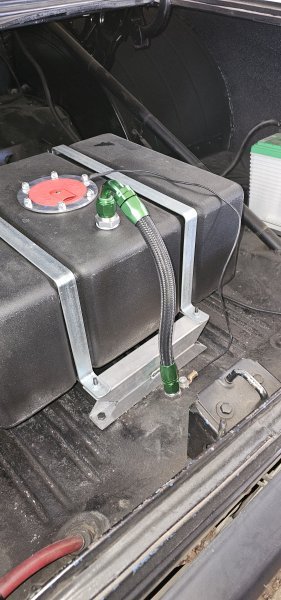

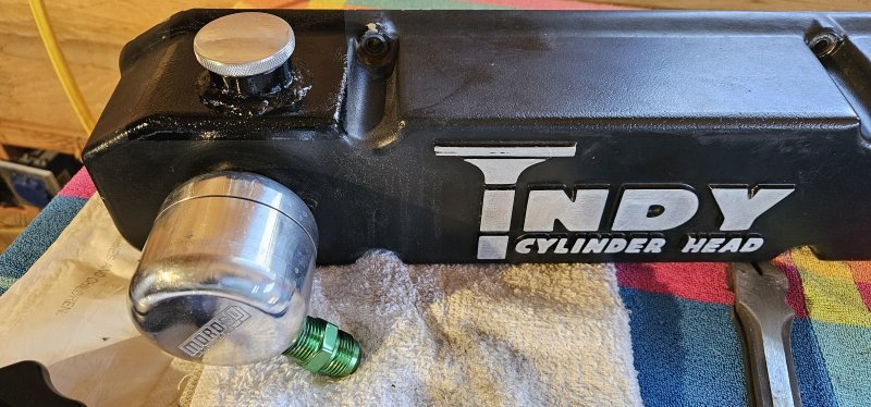

10 Gallon fuel cell with # 10 an return line. Welded the oil fill cap on the valve cover.

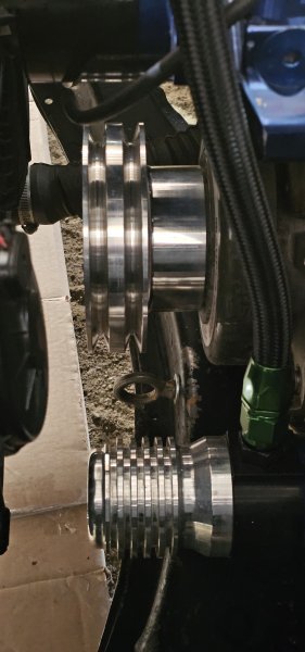

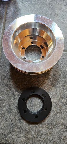

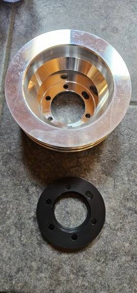

Project race alternator install. Got the alternator and just ordered the crankshaft pulley and spacer for custom install.

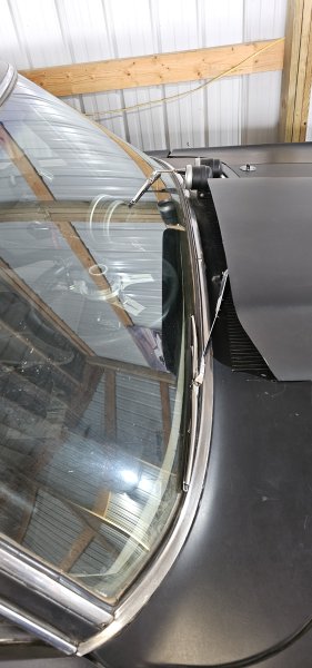

Got the wiper linkage installed and the wipers.

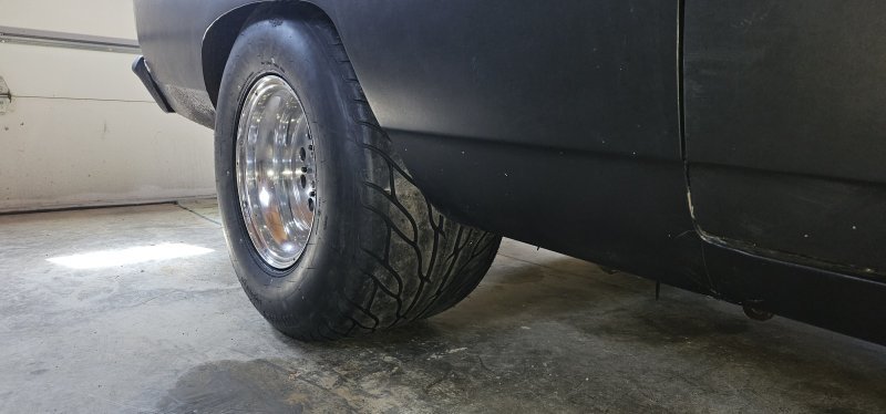

Got the street tires on for the dyno, the steel roller does not like slicks they spin.Heading for some dyno tuning in about 2 weeks.
S
stamm321
What size are those tires??
68RR440hp
68RR440hp
31 x 16-15

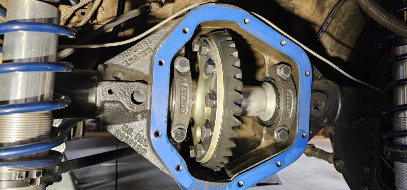

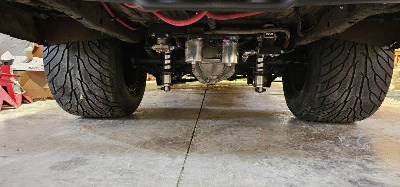

Dana 60 , spool and 410 gears...

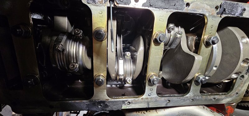

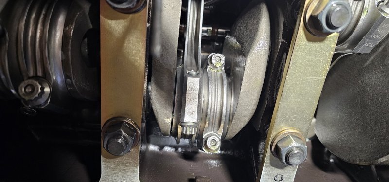

Engine pics

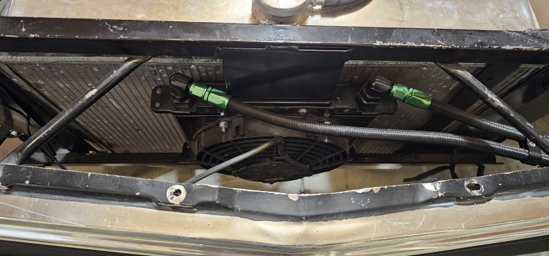

Got the transmission cooler plumbed .

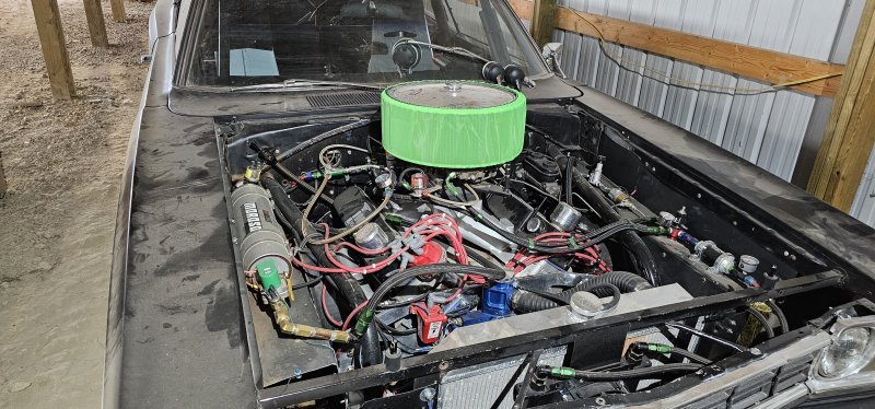

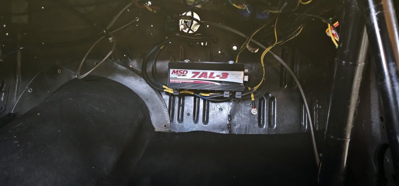

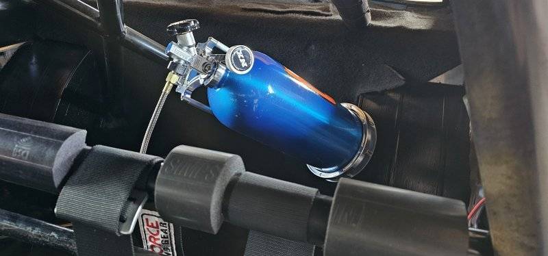

Replaced the Msd 7al box with the 7al3 box for its add'ed features. The nos system needed a timing retard so this worked out great also rewired the whole car.
