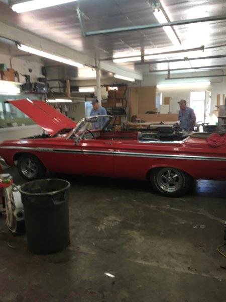

Afriend of mine is working on the interior of this car. Saw it this morning for first time. Solid straight 318, push button, floorpan needs replaced on drivers side. Shop is too small to get good pix. Going red ext. white int., black top. You get the idea. Paid $9600.00 at an auction inMissouri this past fall. Just putting out there what stuff is bringing.

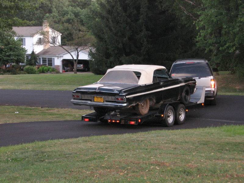

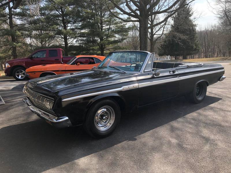

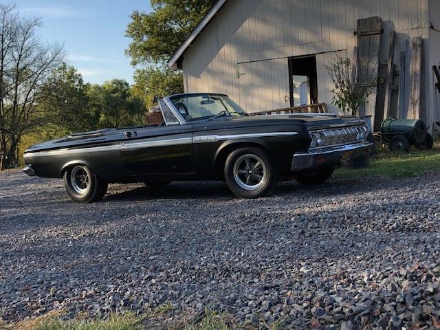

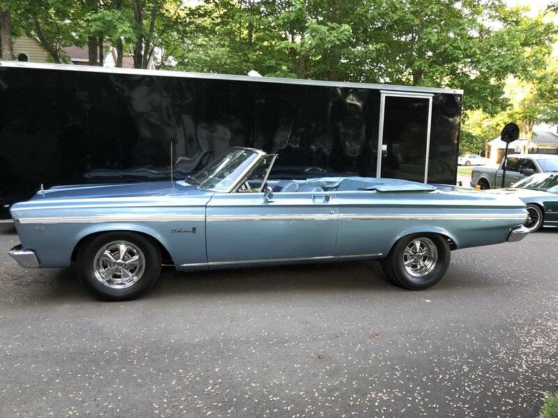

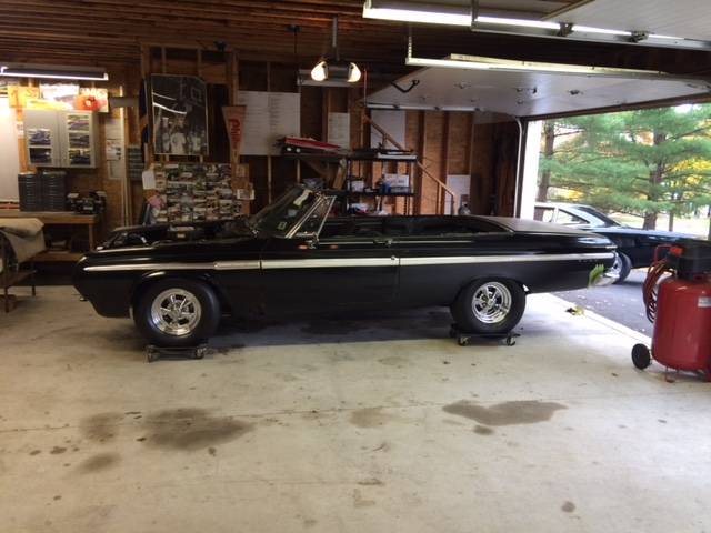

Picked this one up 13-14 years ago. Paid $200 to the original owner. It was rusty in back, but $10k and lots of elbow grease and bartering and now it's one of the most-fun cars to drive! 440/4 speed 3.91 gears. No top and still has the original interior. Spent next to nothing on the body, but everything replaced was blasted and painted and new bushings and.....

I see you have some big meats stuffed up under the back on several different wheels... What size tires you getting up under there ?? Are those wheels 8" or 10" ?? Thanks

Hi Earl. The black steelies and the Cragar SS wheels are 15 x 8" with 4.5" back spacing. The Americans are 15 x 7" with Radir Pie Crust Slicks. The wider tires will rub a bit, but my car sits really low in back. I have 3400 lb Super Stock Springs on it.

Thanks for the reply !! I've seen a couple with 275 60 15's on 15 x 8's...I'm not quite sure i'm going that Big...I'm thinking 255-60-15;s rear and 215 -70-15 front on 15x8 rear and 15 x 7 front....on a White convertible with Torq Thrust D;s
