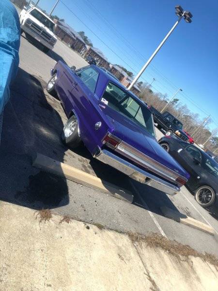

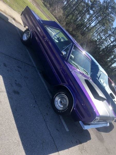

The engine is out of my car and thought I’d look into to changing the rake of my 1967 Satellite. Currently the car is sitting on 14x7 Centerlines, front and back, 4” of backspacing, with 235/60/R14 in the front and 245/60/R14 in the back. It’s way too small for my current taste. I’d like much taller and much wider tire in the rear. Something like 315s.
Goes without saying I’ll have to upgrade bigger wheels for better selection.
Can I achieve a good look with the tire on a 15x8 wheel or will 15x10s be necessary.
And the important bit. As I understand it - the widest tire you can into the rear fender well is about - 255. I am not willing to tub the car (I just don’t like cutting metal) but am I willing to maybe flare the lips.
Does anyone know how much tire can go in if I use a spring relocation kit? IIRC it adds about 3 inches of room. For the tire height could I end up installing Super Stock springs to cover me? Does anyone have experience in this field? What about shorting or adjusting the axles locations.

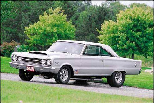

Im going for a very 80s, boy racer, street machine look. High in the rear but not quite the “stink bug” look. If it helps I find the Motown “Silver Bullet” GTX look to be almost the perfect idea of what I’m going for except just a little wider tires.

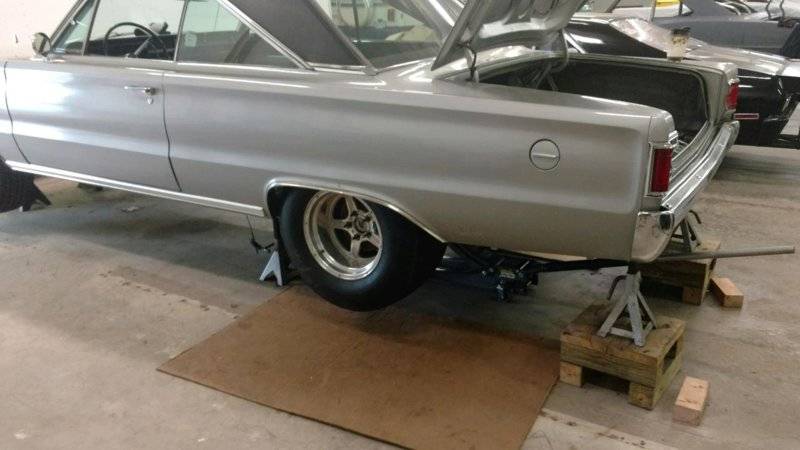

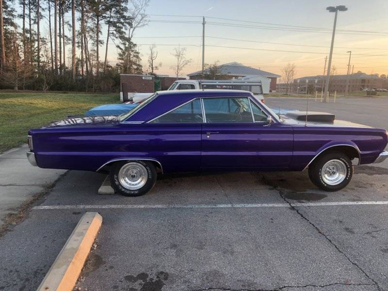

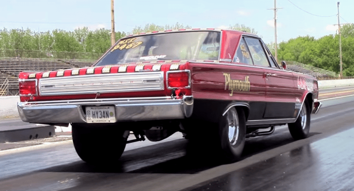

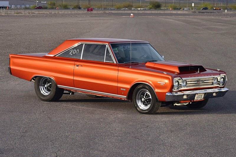

A3DCD627-C5A2-4BD5-86B6-429D6D604736.jpeg 622A3A89-FDD8-49FB-9145-E8726E310D57.jpeg View attachment 911021 View attachment 911023 7A21599D-DF7C-4D2B-9DEC-DD0CB3B9B88A.jpeg View attachment 911028 0DD707E9-68F2-4805-9790-1F6FA9F9D90F.png 3C76222C-55CE-434F-BCFC-5AB27F0CD26C.jpeg A663537D-B47E-4862-A9DB-1B633F4B9D73.jpeg
The rear fenders on the Silver Bullet were flared out.
Look close.
Without tubbing it, I don't see how you will get a 10" wheel under it.

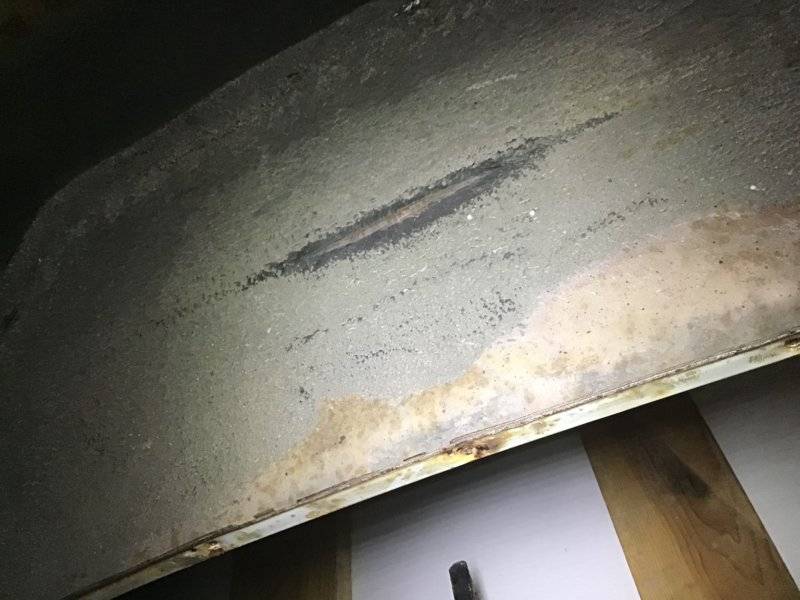

A 275/60-15 is a great look you can have without much work. The outer wheel house is where it will rub, not the lip.

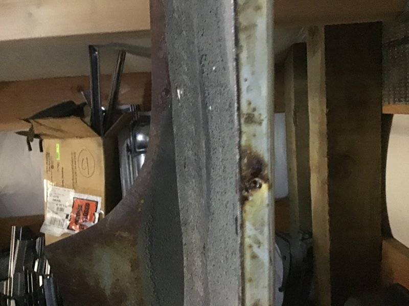

look at these pictures.
1st is the outer wheel house, look where the tire rubbed off the undercoating. This needs to be moved outward. I did this by scraping off the undercoating, heating. With a. Torch and pushing it out with a piece of wood powered by a bottle jack against the inner wheelhouse, worked GREAT!
2nd picture is looking straight up from the bottom, see how that outer wheel house sticks in further than the wheel lip?
go look at your car and feel up there.
You will NOT be putting a 315 tire on this car without cutting on it.

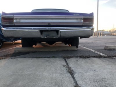

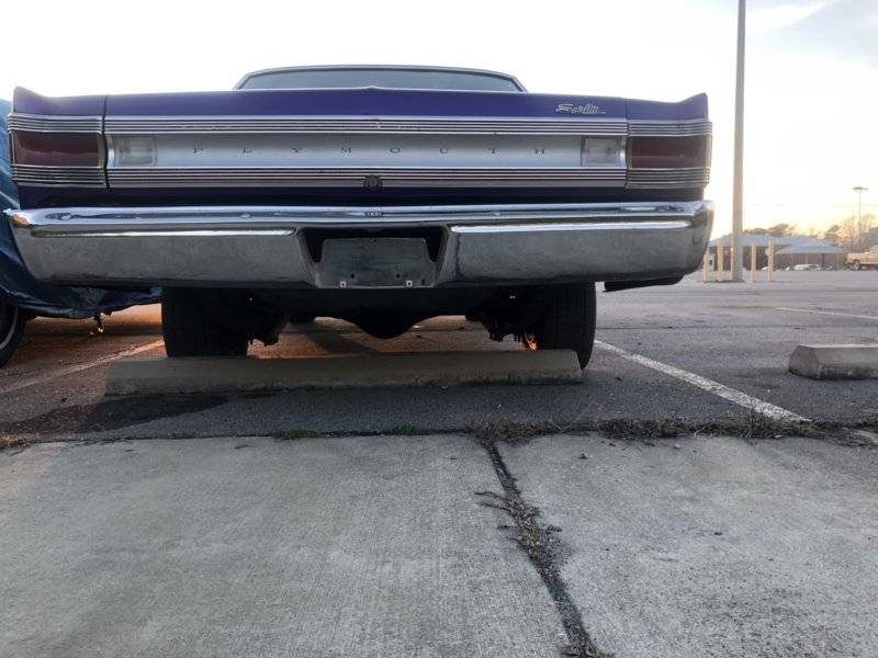

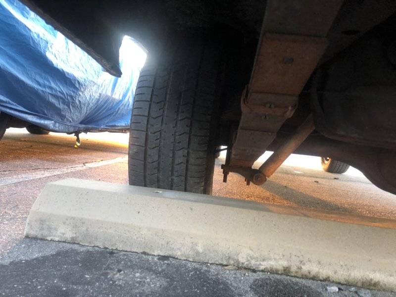

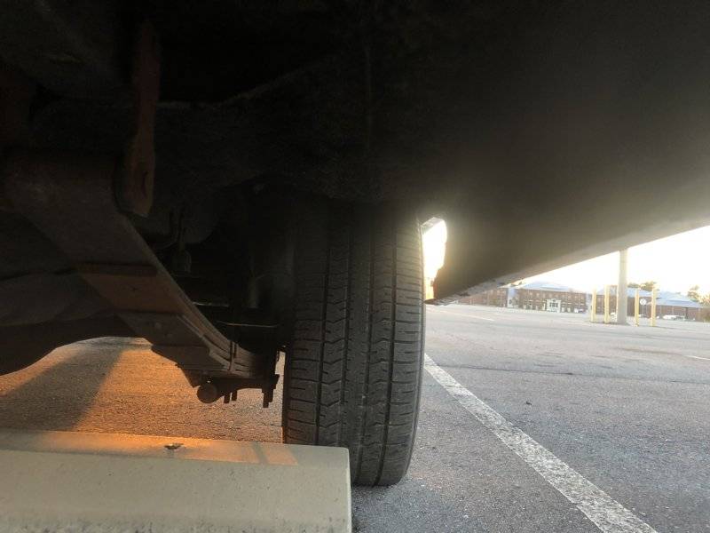

Mini tubs will give you about 3" and you will have to move the springs into the frame to take advantage of that......which will be the next move on my 66.

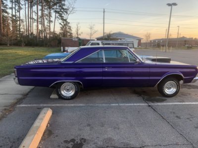

To bad you have those lousy sideways pics, it really makes it hard for giving you a honest opinion about what your looking for. Good Luck

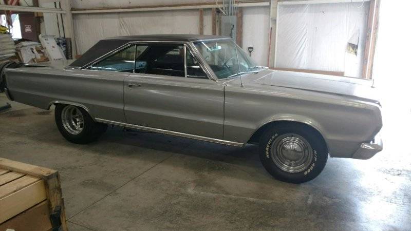

Sorry wasn’t thinking about that. The only full side profile pictures I have is with the motor out. Didn’t wanna post and give the wrong impression about the height.
E5ED49DE-0D7B-4827-A752-907E1E82E063.jpeg E466627C-E738-49BB-9042-D6E779BBE9A5.jpeg 45EC49CD-DF32-45C8-BA1D-2F1857599454.jpeg 5478CEFF-2524-4D50-886B-35A1969695AC.jpeg
