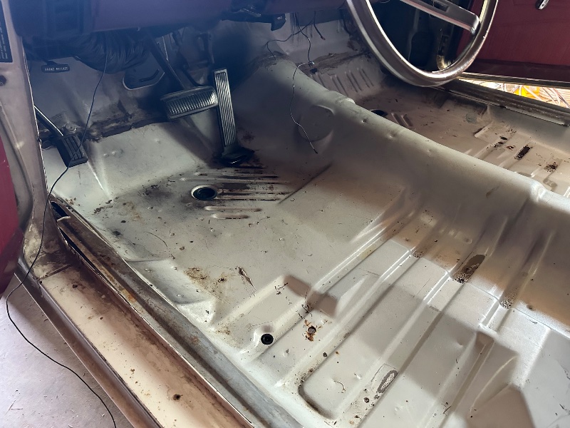

‘68 Bee finally getting some love.
So making slow progress, but getting there. Box just needs vacuum lines, blower, and reinstall. I took lots of pictures like suggested but not enough. The linkage was a royal PITA to get back together. Hope it’s right. Going through the blower motor, then tach/clock rebuild. Clock kit and panel limiter supposedly arrive today.
Yes pic are a must if you don’t do these all the time. I used DMT and replaced heater core and bypass valve from OLD AIR. It fits nice and the evaporator was cleaned and pressure checked along with the new heater core. Still have another one to rebuild for my 70 GTX.nice job!!
