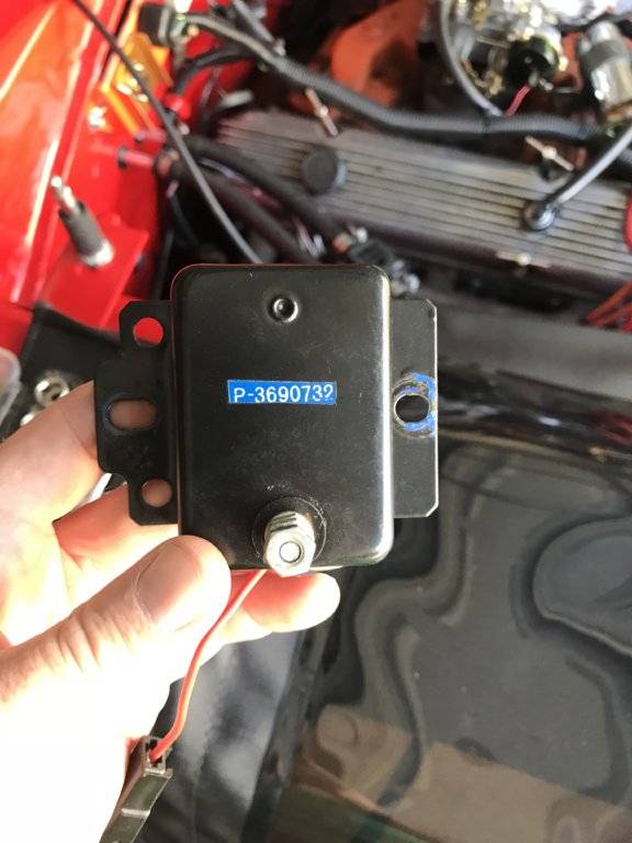

So my regulator went bad and I’m replacing that. Decided to replace the voltage regulator also. I didn’t test it but figured it’s old so why not. Looked up the part number and found it at Summit. Description says “race only”. My motor is a stock 383 4 barrel intake with mopar electronic ignition. Nothing done to it performance wise except headers.
Should I go back to a stock one or replace it with the same one? Why’s it Race only?

Those were supposed to be a constant voltage regulator, did not compensate voltage for temperature. Never was a problem, I think they regulate at about 13.5 volts?
Might be an issue in cold winter weather when the regulators normally put out around 14 volts or so?
There is an electronic replacement regulator that looks like the stock units that works good too.

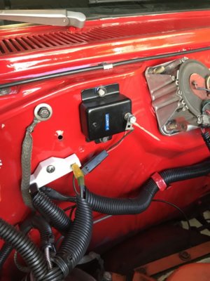

I have a "race" style regulator P3690732 for early style alternator. My alternator is a two field, modified to a one wire early style. Mine puts out more than the advertised 13.5 V, like above 14.5 V. Works fine. The true OE style regulator was grounded through the regulator case to the body. In 1971 I fought the grounding issue for 1 1/2 years. The dealer didn't understand the ground issue & need. A separate ground wire from the regulator case to a sanded paint free body connection point cured the problem for good.

A bad ground could cause the regulator to regulate to a higher voltage.
It will regulate the voltage to what is between the IGN terminal and the regulator case. Resistance or voltage drop on either side (IGN circuit or Ground) can result in the alternator outputing a higher voltage when measured at the alternator output wiring to engine block or alternator case.
Not sure about more than one wire at the IGN terminal. It only needs one, but it would be an easy connection point to get IGN power for other items like the Ignition ECU power or electric choke power.
My experience with a bad ground for voltage regulator resulted in NO output from the alternator.
I had a bad VR on a dodge van that spiked the voltage, cooking the battery and basically blew every light in the system. Figured it fused inside and sent full voltage to the alt field. A bad ground can cause voltage to become erratic on some devices.
