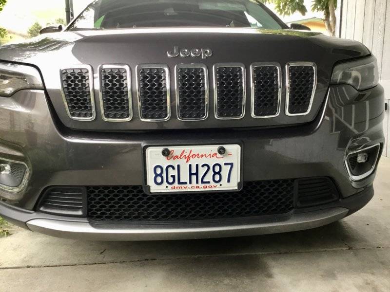

Anyone had this bumper cover off? Is there a push in fastener or should I not **** with it and make it worse.
Unbelievable Dennis....Don’t touch it. Their screwup. Let them fix it. A free loaner car for Linda is in the works I hope. Glad the stalling issue is fixed.:thumbsup:

Done. Linda took it in. 5th trip. Said it needed clips. Gap is closed. Guess it didn’t need clips the first time. Gotta stay on them, make multiple trips and bust their *** to get satisfaction. Looks good but shouldn’t be this hard.
