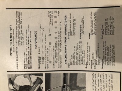

Can you do a 1/4 estimate on the very mild 426 I talked about? Stock they ran about 15. teens so I think with headers, 4.10 gears and the car on a diet (no p/s or brakes) 14.teens is realistic. Elect ign., slicks, cold intake. Steel flywheel, scattershield, solid mtr mounts and torque strap cuz right foot has to be on the floor the whole 1/4 mile. I C.C. and mill heads. It all helps. With an automatic I would use a 440 cast crank and dampener (22 pounds less weight)
Given this 15.2 at 95.5, and that with 2.94:1 and original tires. You’ll have headers, a notable difference, good traction and gears I’d think you’re about right with 14.00 @ 100.
